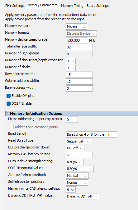

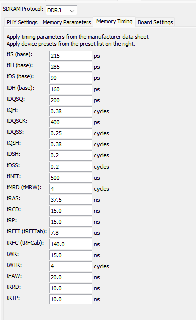

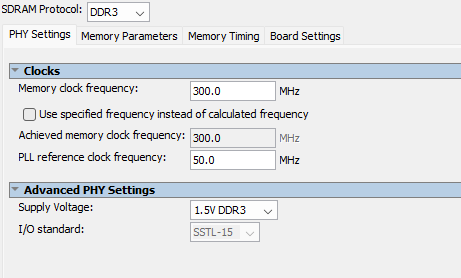

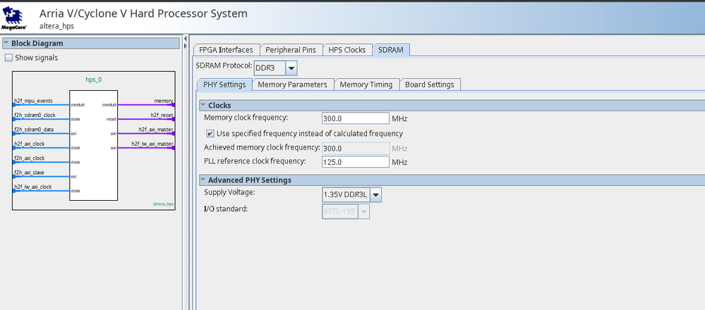

Could you share a screenshot of all the DDR setting that you have currently made in the quartus project?

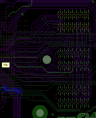

First allow me to rephase the layout.
it is used fly-by and byte pin are swapped. i.e. DQ0-DQ7 <-> HPS DQ0-DQ7 is allowed to interchange any pins.
DQ DQM DQS are routed length matched.
All address are strictly followed no pin exchange and length matched.

The Qsys:
Board settings are not modified as EVM/EVB from other company work normally during development on software side and PL side do not modify those parameter as well. - BrianSune_Froum

No your information is only based on words of the documents.
But what altera reference had done is violated what the document said.
Can you see the image attachment?https://community.intel.com/t5/Programmable-Devices/Custom-board-on-Cyclone-V-SoC-HPS-SDRAM-topology-unclear/m-p/1703953#M100767
I am completely lost and so confused with the actual hardware result (not simulation not just theory level).
What we had tried is also mentioned in that ticket.
If leveling is not allowed then it is supposed to fail no matter how on the fly-by /w two die in fly-by layout.
But results are not align it can passed all stress test with thermal profile 60 degree so fast slow corner are all passed.
The only differences are the DDR3 die is 1K page or 2K page in previous fails.

I think you had misread my descriptions on previous post.
What I am pointing out it that the official development board from altera itself already violated the design rules.
If leveling is not supported then as you mentioned clearly it is not allow to use fly-by from first place.
But according to the allegro design file from the board design.With this image of the official altera design layout. it already violated the Balance-T design.
There is a ECC at one end but not middle and it does not follow a T branch design but a fly-by hybird layout.
So please explain why this is the case. - BrianSune_Froum

Final solved the 2K pagesize problem for 2K the precharge time is critical on the settings.
Same Quartus 18.1 just need to tune the parameters more tediously.
And also even w/o the leveling as datasheet mentioned. There are no issues on fly-by design.
