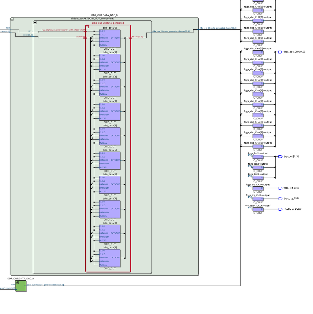

I'm building a 10-bit parallel output interface to drive a DAC. I'm using the oddr (ALTDDIO_OUT) registers so that all bits output simultaneously. 9 of the 10 bits are aligned, while one has an additional delay of about 2 nsec.
I created two 10-bit buses (to drive two DACs), and the strange thing is that bit (3) is always delayed on both buses.
I'm attaching the project, hoping some experts can help me.

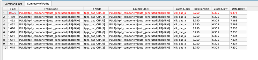

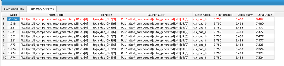

The ddr registers are correctly instantiated, but in the timing analysis, the bit(3) coming out of the fpga is delayed compared to all the others:
TIMING ON BUS_A:
TIMING ON BUS_B:
REGULAR DELAY:
BIG DELAY:

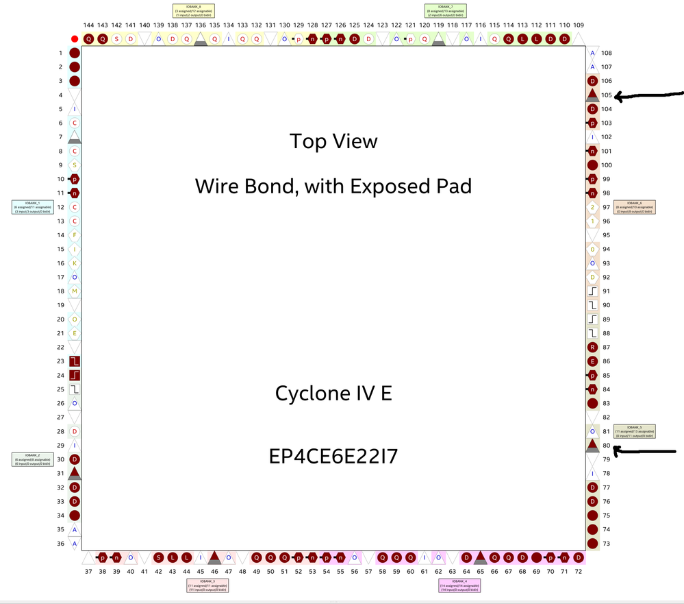

The only difference I see is that the "slow" pins are both also Vrefs (pin 105 and pin 80):
Could this be the reason?

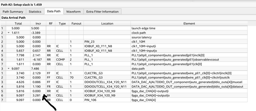

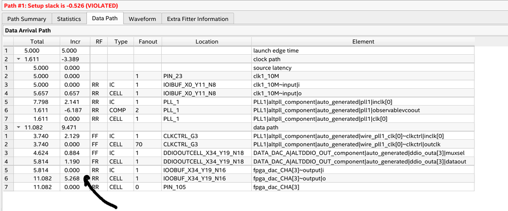

  • The routing delay difference due to different type of pin assigned.
    The bit fpga_dac_CHA[3] using this type of pin:
    While other bits using these type of pin:
    Different pin type will have different internal routing delay and this is fix one which cannot be changed.
    So if change bit fpga_dac_CHA[3] and fpga_dac_CHB[3] pins to for example PIN_115 and PIN_120. The timing will be similar for all bits:

    That's right, the OP's original assumption was correct. Different types of dual-purpose pins have different propagation delay. I can't see this clearly stated in any documentation, but it definitely seems so. For the types above, identified by pin number, the varying part is as follows:
    • 105: 4.393 ns
    • 103: 3.281 ns
    • 110: 3.128 ns
    So if you want to do a source-synchronous interface with as little data skew as possible, make sure all your data bits are driven from the same type of I/Os. At least avoid the VREF ones.
    On a side note, the slack mentioned above seems to refer to the falling edge of the launch clock to the rising edge of the latch clock. I think that is a false path, the data is only meant to change on rising edges. So the slack is actually better by 5 ns, but if you really need to run as fast a possible you need to reduce that data skew.

    If you look at the first 2 lines you will notice that the 'data delay' value is about 1 nanosecond greater than all the other lines. Using the ODDRs I expected differences on the order of 100-200 picoseconds between all the pins. This is what I can't understand.

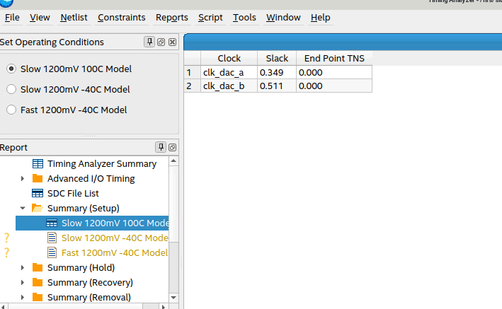

    GOMEZ_IT
    Hi Sheng. Can you share the timing analisys from Pll1/clk0 clock to clk_dac_a or clk_dac_b clocks?
