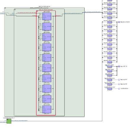

CYCLONE IVE ODDR delay mismatch
Hello Altera Experts! I am using Quartus Standard 24.1.. I'm building a 10-bit parallel output interface to drive a DAC. I'm using the oddr (ALTDDIO_OUT) registers so that all bits output simultane...
