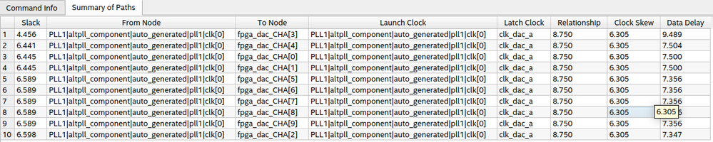

The routing delay difference due to different type of pin assigned.
The bit fpga_dac_CHA[3] using this type of pin:
While other bits using these type of pin:
Different pin type will have different internal routing delay and this is fix one which cannot be changed.
So if change bit fpga_dac_CHA[3] and fpga_dac_CHB[3] pins to for example PIN_115 and PIN_120. The timing will be similar for all bits:

I added this
set_false_path \ -fall_from [get_clocks {PLL1|altpll_component|auto_generated|pll1|clk[0]}] \ -rise_to [get_clocks {clk_dac_a}]into your sdc file, and that seemed to do the trick. The Timing Analyzer now says
