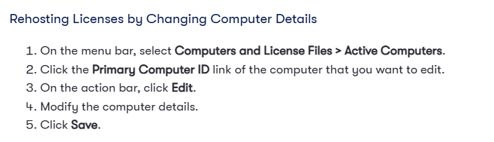

        However, there may be another option. If you still have access to the original SSLC account used to generate these licenses, including the owner email address and login credentials, you may be able to rehost the license to the new server through SSLC (https://licensing.altera.com/sslc/s/)

        Thank you for sharing the license file. At this time, the licensing team is unable to support transferring or reassigning the existing license to a new server. Therefore, obtaining a new license through the University Program process would be the recommended path moving forward.
        However, there may be another option, if you still have access to the original SSLC account used to generate these licenses (including the owner email address and login credentials), you may be able to rehost the license to the new server through the SSLC self-service process. Based on the license file you provided, I noticed that the licenses have maintenance expiration dates until 2030 and 2040.
        You  may refer to Section 6.6.13, "Rehosting All Licenses from Current Computer to a Different Computer," in the Altera FPGA Software Installation and Licensing User Guide (https://docs.altera.com/r/docs/683472/26.1/altera-fpga-software-installation-and-licensing/answers-to-top-faqs). You may be able to rehost the license to the new server by following the documented steps.
        Kindly let me know if we are able to proceed with this. Thank you.
