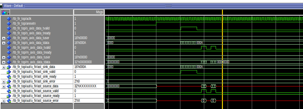

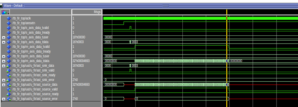

Why does my Altera FIR IP, configured for interpolation by 80, produce the expected outputs when I provide 3 input samples, but fail to produce the expected behavior when I provide 10 input samples? In this case, the FIR IP keeps tready asserted high, but only generates 4 valid outputs. What could be causing this behavior? I am simulating this in Quartus Prime Lite Edition.

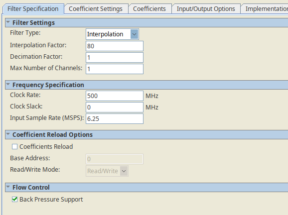

    This is how I configured my fir ip
    I have attched simulation outputs for 10 & 3 inputs.

    Just a thought - if you specify 6.25M input sample rate and a clock rate of 500M, you are specifying an oversample rate of 80x.  This implies that you should see an input sample 1 in every 80 clock cycles on the input (and then receive full rate data @ 500M on the output).  You are likely overflowing the FSM inside the IP.  With that said, I believe you should be seeing tready go low.  What version of Quartus / IP are you using here?
  • saasha's avatar
    saasha
    I am using Quartus prime lite 25.1 version.
    But I was not able to see tready go low. I even tried providing inputs to the FIR once every 80 clock cycles.

    Hello - please see attached.  In reviewing the documentation, a single-channel interpolation use case is not well documented, and we are discussing internally on how to better articulate this and use the tvalid/tready on the sink side.  Currently, the documentation states that it is a pass-thru from the tready on the source side (which is how it is behaving).
    If you change your input to align with attached image, it should behave better.  This would mean modulating the tvalid input to assert 1-in-80 clock cycles.  If you receive in bursts, you should FIFO to holdoff.
    • saasha's avatar
      saasha
      Hi Jeffc,
      I had tried this one, this was giving expected number of outputs.
      • JeffC_Altera's avatar
        JeffC_Altera
        To be clear - does this allow you to move forward right now?  The functionality of "tready" is only a pass-through of the tready on the source side (input).  Per the documentation, it's not a function of the current status of the internal FIR.  So, you need to create your signaling to match the system behavior, which is what I articulated in the drawing.  If you are seeing bursts of data coming in, you might need to add a simple FIFO/buffer that pulls data out at the 1-in-80 and absorbs bursts on the write side (not to exceed a net rate of 1-in-80, of course).
