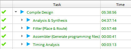

When building the whole FPGA it takes 5.5h on the i7 8700K and 3h on the i9 12900K machine.
Most of the time is spent in Analysis&Synthesis: the i7 takes about 4h and the i9 2.5h here.
I assume that this is caused by the same problem that causes the top level file to be opened so slowly.

Is the compilation time also okay when most of it is spent in A&S? The Fitter took the longest in the projects I have worked on before.
I worked on a project using the same FPGA (Arria 10 GX 270kLE) that consumed a higher percentage of the logic and memory and took about 1 hour to build and not nearly as long to open the top level qsys file, but I don't remeber the relation between time spent in A&S and Fitter anymore.These are all the messages that appear when opening said qsys file:

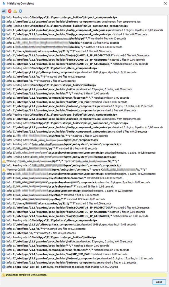

I hope it is possible to read them. I also attached them as a file.
There doesn't seem to happen anything out of the ordinary but it took 2.5h with the i9 12900K and 64 GB RAM.All of the files are on the local SSD, independent of the machines used so far.

In the messages, do you notice where it's hanging up for long periods of time? The messages don't show any long delays.

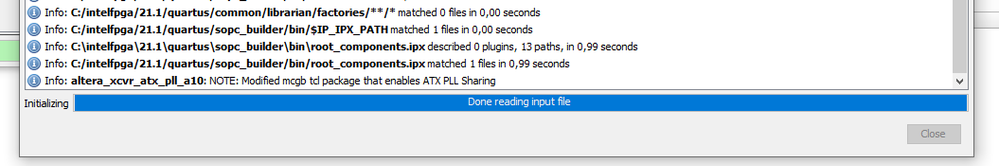

I checked the window multiple times while opening the top level system and it gets to the last step pretty fast. There's no line added after that and it even stays at "Done reading input file" the whole time. Then after 2.5h it suddenly finishes opening.

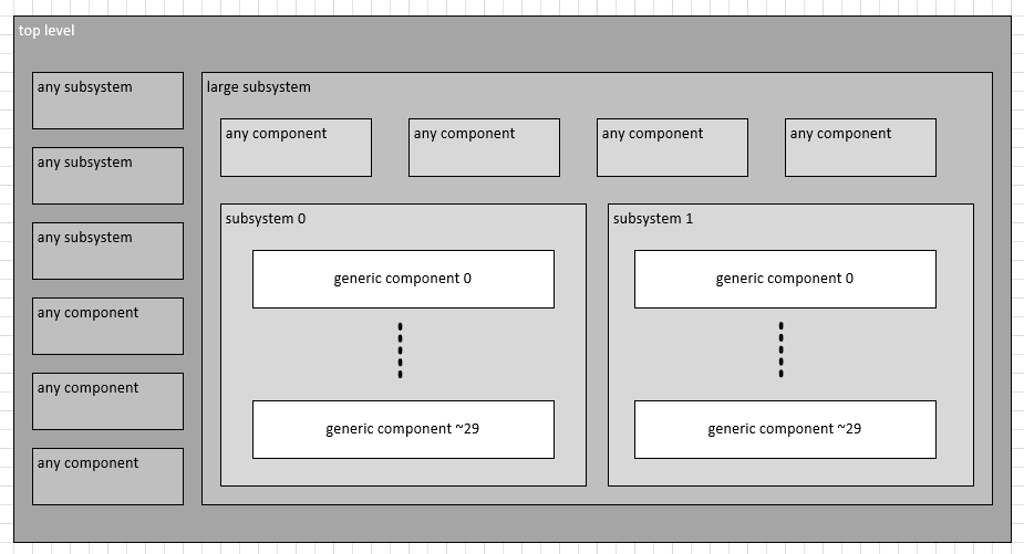

- FHint
So far none of the (sub-)systems seems to be corrupted. When recreating the subsystems and instantiating them in the top level the platform designer starts to get really slow. So slow that for adding a single connection on top level it takes minutes if not an hour.
Can the file size per se be a problem? The top level .qsys has about 180 kB in size and the subsystems range from 10 to 90 kB. The one that has 90 kB e.g. is instantiated two times in the whole design.
Are generic components a problem? As mentioned above I instantiate the same generic component about 60 times in the whole design with different parameters. Depending on the parameters set the component chooses which FIFO to instantiate in its VHDL code (it chooses 1 of 5 FIFO). The 5 FIFO are referenced in the hw.tcl of the component and are instantiated in the VHDL code via a "if .. generate" depending on the parameter set.
Or can elaboration callback functions cause the problem? This generic component's hw.tcl also includes an elaboration callback of about 100 lines in code. Bit I had tried to "simplify" the component by splitting it up in multiple "pre defined" components with little to no parameters and lines in the callback function and the performance didn't improve.
Florian - sstrell
Are each of these 60 components completely unique? Or are you saying that you created just one custom component and when it's instantiated, a parameter lets you select the FIFO type? If you're having 60 completely unique components all requiring to run elaboration callbacks then that could certainly be the cause.
- FHint
It's one generic component with 25 parameters, but 16 of them are derived.
One of these parameters (non-derived) chooses which of the 5 FIFO is instantiated in the VHDL.
The other parameters are either used within the VHDL code, specify port widths or both.
The 16 derived parameters are set within the elaboration callback.So yes, it's one custom component that is instantiated ~60 times with different parameters.

I'm running out of ideas. Can you break down these components into multiple subsystems, leaving the top basically empty except for subsystem instantiations and connections?
I don't know how complex this custom component is but it is clearly the cause of the problem. How many parameters are there?
- FHint
The top level system only includes subsystems and some components (e.g. PCIe HIP, some register). It instantiates one larger subsystem, that also contains some components (e.g. Avalon-MM bridge), but also 2 instances of one subsystem. These two subsystems contain the ~60 custom generic components - so ~30 for each. I tried to show the basic hierarchy in the image below:
The top level qsys doesn't contain anything but instantiations and connections or do I misundertsand you?
As mentioned above the custom generic component has 25 parameters but 16 of them are derived and set during the elaboration callback. Some of these parameter salso define the port widths of interfaces and one chooses the FIFO. The elaboration callback function is about 100 LoC in the hw.tcl file. The VHDL code of the custom generic component is ~700 LoC, but the VHDL shouldn't be analyzed when opening the top level qsys file anyway or is it?
Florian- sstrell
