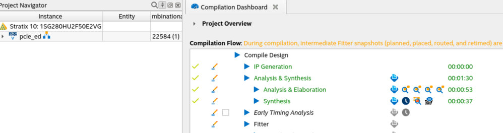

Simulating L-Tile and H-Tile Avalon MM+ Intel FPGA IP for PCI Express using Questa
I'm following the user guide L-Tile and H-Tile Avalon MM+ Intel FPGA IP for PCI Express and using Questa Intel FPGA Edition to simulate. This is for Quartus Prime Design Suite 23.4.
I followed the procedure to generate a test design using Quartus Prime Pro, and I changed the working directory to the design/pcie_design_tb/pcie_design_tb/sim/mentor/
However on page 16 where it says I should invoke vsim which it said brings up a console where I can run the following commands, which it lists as do msim_setup.tcl then ld_debug and run -all
However when I invoke vsim, it expects me to put in the testbench design. Without this it complains that "No Design Loaded!" and it wont run. Or I will try the ld_debug and run -all it will try to compile with over 2500 warnings and one fatal error saying no design loaded.
Not sure if this is an error in the user guide. The transcript window is used to input paramaters, not by invoking vsim.
I'm using the DMA design.
Can someone assist me step by step on how I can sucessfully compile this design?
