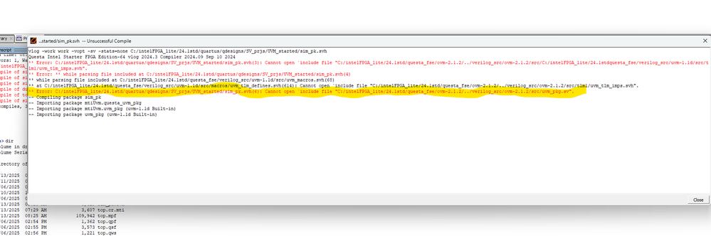

Hi ,
I am trying to compile and run simulation in Questasim , using uvm libraries and uvm packages.
But i am getting error that include files not defined , although these uvm files are installed in verilog_src folder at Questasim installed path.
See screen shots and sv files attached.
Any tip or guide how to direct compiler to pick the installed uvm files.

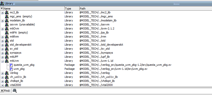

Tool Info:
Questa Intel FPGA Edition-64 2024.1Revision: 2024.04

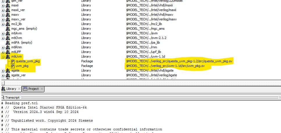

- Fpga_Egr_2025
HI tried to compile and run using Intel Questasim , but still it wont find uvm macros :
And i can also see that the uvm package files in the linked libraries :

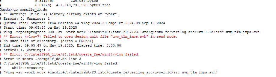

- Fpga_Egr_2025

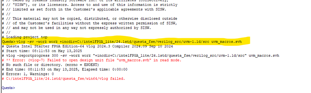

Hi I tried to compile and include in the working directory , but no success in linking "uvm_macros.svh" .
It is dependent on "uvm_tlm_imps.svh" , which vlog did not complain about , but when i tried to include "uvm_macros.svh" it refers to "uvm_tlm_imps.svh".
Any clue what should be the compile order ? to fix this
See image attached.

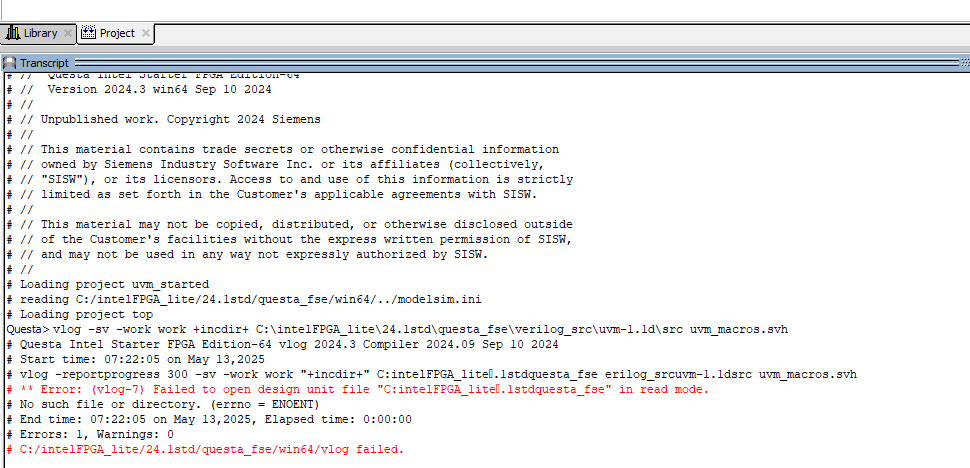

- RichardT_altera
Are you using correct command?
I think you should run
vlog -sv -work work +incdir+C:/intelFPGA_lite/24.1std/questa_fse/verilog_src/uvm-1.1d/src uvm_sim_pk.sv
(there is a space in between uvm_sim_pk.sv and _incdir+C...)
instead of
vlog -sv -work work +incdir+C:/intelFPGA_lite/24.1std/questa_fse/verilog_src/uvm-1.1d/src/tlml/uvm_tlm_imps.svh
Richard Tan

- RichardT_altera
Again, you use the wrong command.
Use:
Not
vlog -sv -work work +incdir+C:\intelFPGA_lite\24.1std\questa_fse\verilog_src\uvm-1.1d\src uvm_sim_pk.sv
That's likely what mess up the path name.Regards,

- Fpga_Egr_2025
still its not working , i am getting error msg that questasim cannot open uvm_macros.svh in read mode.
Although i am running questasim in admin mode .

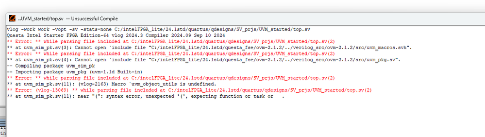

- Fpga_Egr_2025
yes in one module "dut" it was spelled wrong but still compilation results in error of not finding the uvm_pkg .
i have made some changes see below :
//uvm_sim_pk//
`ifndef UVM_SIM_PK
`define UVM_SIM_PKpackage uvm_sim_pk;
`include "C:/intelFPGA_lite/24.1std/questa_fse/verilog_src/uvm-1.1d/src/tlm1/uvm_tlm_imps.svh"
`include "C:/intelFPGA_lite/24.1std/questa_fse/verilog_src/uvm-1.1d/src/uvm_pkg.sv"
`include "uvm_macros.svh"
import uvm_pkg::*;
class my_transaction extends uvm_sequence_item;
`uvm_object_utils(my_transaction)
rand int addr;
rand int data;
rand bit r0w1;
function new (string name = "");
// Without a string name the transaction would be anonymous
super.new(name);
endfunction: new///////////////////////////////////////////////////////////////////////////////////////////////
//top.sv//
`include "uvm_sim_pk.sv"
module top;import uvm_sim_pk::*;
dut_if dut_if1 ();
dut dut1 ( .i_f(dut_if1) );// Test classes are better placed in a package, but defining the class here
// avoids the need to introduce set_config_db to connect the virtual interface
// in this very simple example//////////////////////////////////////////////////////////////////////////////////////////////
//dut.sv//
interface dut_if();
`include "uvm_pkg.sv"
import uvm_pkg::*;int addr;
int data;
bit r0w1;modport test (output addr, data, r0w1);
modport dut (input addr, data, r0w1);////////////////////////////////////////////////////////////////////////
// do file //
## Questasim do file ##
vlib work
vlog -sv -work work +incdir+C:/intelFPGA/23.1std/questa_fe/verilog_src/uvm-1.1d/src uvm_tlm_imps.svh
vlog -sv -work work +incdir+C:/intelFPGA/23.1std/questa_fe/verilog_src/uvm-1.1d/src uvm_pkg.sv
vlog -sv -work work +incdir+C:/intelFPGA/23.1std/questa_fe/verilog_src/uvm-1.1d/src uvm_sim_pk.sv
vlog -sv -work work +incdir+C:/intelFPGA/23.1std/questa_fe/verilog_src/uvm-1.1d/src dut.sv
vlog -sv -work work +incdir+C:/intelFPGA/23.1std/questa_fe/verilog_src/uvm-1.1d/src top.sv/////////////////////////////////////////////////////////////////////////
But i still this error :
- RichardT_altera
Its a UVM guideline to use .sv extensions for compile files and .svh for `include files.
You're trying to compile uvm_tlm_imps.svh directly:vlog -sv -work work +incdir+C:/intelFPGA/23.1std/questa_fe/verilog_src/uvm-1.1d/src uvm_tlm_imps.svh
This is incorrect. Remove that line — the uvm_tlm_imps.svh file will be included inside other UVM source files (like uvm_pkg.sv) automatically.
