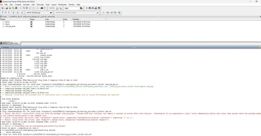

Here is the questasim compile result :

I then changed the do file script to include my modules i.e dut.sv and top.sv like this :
## Questasim do file ##
vlib work
vlog -sv -work work +incdir+C:/intelFPGA/23.1std/questa_fe/verilog_src/uvm-1.1d/src uvm_sim_pk.sv
vlog -sv -work work +incdir+C:/intelFPGA/23.1std/questa_fe/verilog_src/uvm-1.1d/src dut.sv
vlog -sv -work work +incdir+C:/intelFPGA/23.1std/questa_fe/verilog_src/uvm-1.1d/src top.svin my dut.sv : ------------------------------
