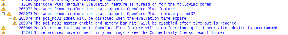

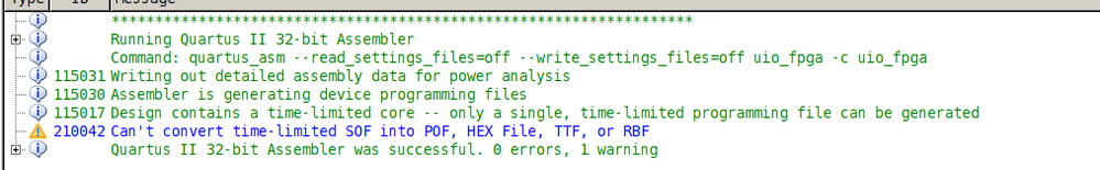

  • Phil87's avatar
    Phil87
    I tried using the "Discontinued" license you suggested. It didn't work either. I still get this:
    And this during assembly:
    Is it a fact that the full PCI Megafunction feature can no longer be purchased or obtained?
