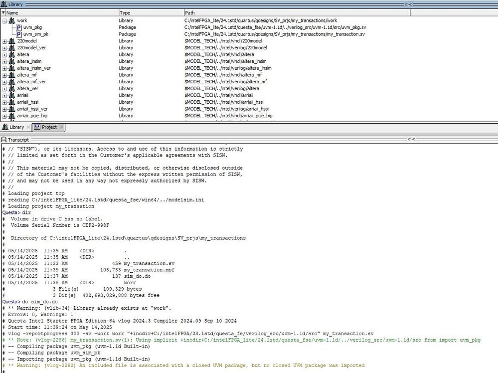

still its not working , i am getting error msg that questasim cannot open uvm_macros.svh in read mode.
Although i am running questasim in admin mode .

Here is the questasim compile result :
- Fpga_Egr_20251 year ago
