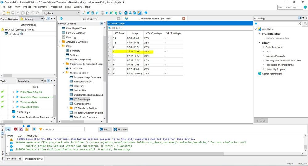

      1. With just LVDS TX & RX with VCCIO=3.3V - Compilation passed
      2. Along with '1' I added 1 input single ended (defined as 3.3V LVCMOS in Assignment editor) signal to the same bank - Compilation passed
      3. Along with '2' I added 1 output single ended (defined as 3.3V LVCMOS in Assignment editor) signal to the same bank - Compilation failed.
      Got an error saying there is no IO voltage compatibility between the IO pins.
      According to your statement above, we are still working all at 3.3V level, yet we get a error which says we are not right.
      Could you give me some confirmation on this please?

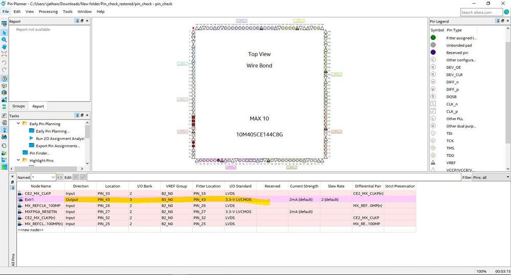

      The errors are as below:
      ""Warning (15714): Some pins have incomplete I/O assignments. Refer to the I/O Assignment Warnings report for details
      Warning (176674): Following 2 pins are differential I/O pins but do not have their complement pins. Hence, the Fitter automatically created the complement pins.
      Warning (176118): Pin "MX_REFCLK_100MP" is a differential I/O pin but does not have its complement pin. Hence, fitter automatically created the complement pin "MX_REFCLK_100MP(n)"
      Warning (176118): Pin "CE2_MX_CLKP" is a differential I/O pin but does not have its complement pin. Hence, fitter automatically created the complement pin "CE2_MX_CLKP(n)"
      Error (169236): Can't place I/O pin Extr1 in assigned location IOBANK_2 made by User Location Constraints source
      Error (169027): Pin Extr1 is incompatible with I/O bank 2. Pin uses I/O standard 3.0-V LVCMOS, which has a VCCIO requirement incompatible with that bank's VCCIO setting or other pins that use I/O standard LVDS.
      Info (171121): Fitter preparation operations ending: elapsed time is 00:00:00
      Error (171000): Can't fit design in device
      Warning (169177): 1 pins must meet Intel FPGA requirements for 3.3-, 3.0-, and 2.5-V interfaces. For more information, refer to AN 447: Interfacing MAX 10 Devices with 3.3/3.0/2.5-V LVTTL/LVCMOS I/O Systems.
      Info (169178): Pin MXFPGA_RESETIN uses I/O standard 3.3-V LVCMOS at 27
      Warning (169069): Following 1 pins have nothing, GND, or VCC driving datain port -- changes to this connectivity may change fitting results
      Info (169070): Pin Extr1 has GND driving its datain port
      Error: Quartus Prime I/O Assignment Analysis was unsuccessful. 3 errors, 9 warnings
      Error: Peak virtual memory: 5003 megabytes
      Error: Processing ended: Tue Mar 05 13:36:59 2019
      Error: Elapsed time: 00:00:02
      Error: Total CPU time (on all processors): 00:00:02"

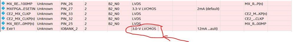

  • Abe's avatar
    Abe
    Well, I just took a look at your pin assignments and see that you have assigned a single IO Bank (Bank 2) with both 3.3V LVCMOS as well as 3.0V LVCMOS. This is a violation of the Bank IO standard rule I mentioned earlier.
    You can only assign one IO standard/voltage to a Bank. Assign the single-ended pins that need a different voltage standard , for eg, 3.0V or 2.5V to another bank and assign the pins accordingly.
    Either Change the voltage standard for the EXTR1 pin to 3.3V LVCMOS or move to another Bank and Pin location.

  • Abe's avatar
    Abe
    The issue is due to the limited number of pins for each bank in the E144 package of Max10 device you're using, each bank can be assigned only a single IO Voltage standard as well as IO Standard.
    Since you've assigned Bank2 as 3.3V LVCMOS and LVDS IO Standard, the IO Buffers in the device for Bank2 are configured as LVDS IO buffers. These can accept single-ended signals as inputs but cannot output single-ended signals.
    The error message says whats wrong:
    Error (169027): Pin Extr1 is incompatible with I/O bank 2. Pin uses I/O standard 3.3-V LVCMOS, which has a VCCIO requirement incompatible with that bank's VCCIO setting or other pins that use I/O standard LVDS.
    If you look at your pin-outs, the other single-ended signal in the same bank (Bank2) is an input, along with two LVDS input clocks. So this is okay. But when you assign output signal which is single-ended to the same LVDS bank, the IO buffer cannot drive the same as single-ended.
    What you need to do is to assign any single-ended output signals in your design to other banks that are configured as 3.3V LVCMOS and non-differential. Assigning the same EXTR1 output to IO Bank 1B just above Bank2 solves the issue and the compile goes through.
    These are the limitations when working with different IO voltages and standards on FPGA devices that you have to keep in mind when assigning pins. Please read the IO documentation before making any pin assignments.

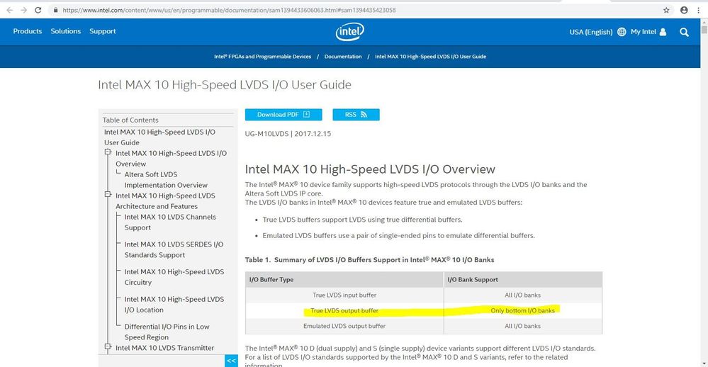

    • NM8's avatar
      NM8
      Hi Vikas,
      Not sure what you are referring to in the link above.
      Are you referring to "Intel MAX 10 LVDS SERDES I/O Standards Support " heading?
      I do want to use the True LVDS & I'm clear with the pins to be used for it.
      Just that confusion whether to give VCCO=2.5V or 3.3V.
      I hope you can clear it. If you recommend to use 2.5V, why not 3.3V and what would be the signal characteristics with 3.3V VCCO.
