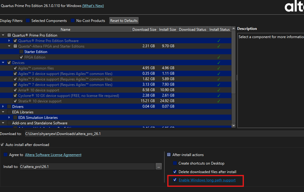

  • Are you referring to the maximum file path length? If so, this is a Windows limitation.
    Windows limits the combined length of a file name and its path to 260 characters. If your project path exceeds this limit, Quartus may be unable to access the required IP or design files.
    Additionally, the Quartus Prime Pro 26.1 installer includes an option to enable Windows Long Path Support by default. Older installers may not provide this option.
    Alternatively, you can refer to the KDB below for instructions on enabling long path support in Windows.
    If the issue persists after enabling long path support, could you share more details, such as the exact compilation error message or logs?

      Looks like it was fixed, my apologies. Didn't realize that was part of the install. Our corporate IT installs so I was not there to see it when it happens. I will go back to IT to see if I can get that fixed.  I wonder why they didn't just make this default. this is basically a check box asking.   " Do you want to be able to build your project anywhere other then then directly off of the C drive without error on windows."

        Hi dscoope,
        Thank you for the clarification.
        Platform Designer generates these filenames to preserve the unique hierarchy and instance identity of the generated IP. To help reduce Windows path-length issues, you may:
        1. Enable the Windows Long Path Support option during Quartus installation.
        2. Avoid placing the Quartus Prime project in a directory far from the drive location.
        We also appreciate your feedback regarding the lengthy and repetitive folder and file names. While we cannot guarantee changes will be implemented, we will document the feedback for future consideration.
