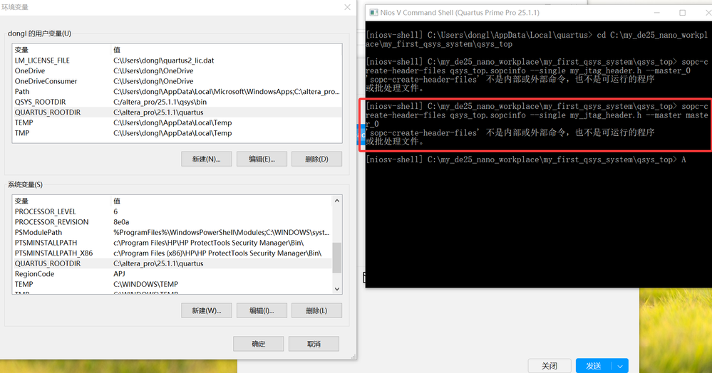

I tried it in Nios V command Shell:

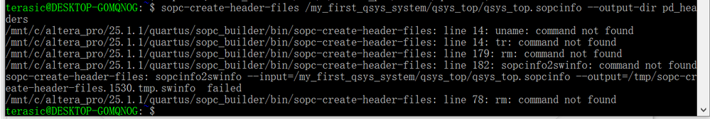

even I used Windows WSL:

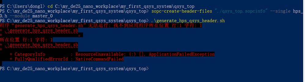

or in Windows PowerShell:

sopc-create-header-files is a bash script so needs to be run on linux or WSL.
There looks to be something wrong with your WSL environment because it is missing many basic linux commands such as `rm` `uname` `tr`. You should be able to execute these in your WSL shell
Once you have fixed your WSL setup, you need to add `quartus/sopc_builder/bin` to your path (inside WSL), because it relies on sopcinfo2swinfo being on your path, and then it should work

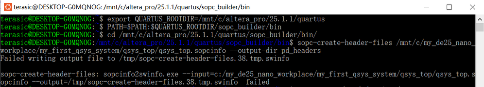

terasic@DESKTOP-G0MQNOG:/mnt/c/altera_pro/25.1.1/quartus/sopc_builder/bin$ sopc-create-header-files /mnt/c/my_de25_nano_workplace/my_first_qsys_system/qsys_top/qsys_top.sopcinfo --output-dir pd_headers
Failed writing output file to /tmp/sopc-create-header-files.38.tmp.swinfo sopc-
create-header-files: sopcinfo2swinfo.exe --input=c:/my_de25_nano_workplace/my_first_qsys_system/qsys_top/qsys_top.sopcinfo --output=/tmp/sopc-create-header-files.38.tmp.swinfo failed
