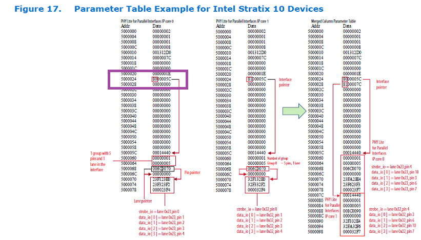

    Hi Samson,
    1. How did you get the address, 0x05000024?
    2. Did you reset the board after the issue happens? For example, reset the board and power on, run the design then issue occurs, reset the board and run again.
    Rashmi
    • LHinC1's avatar
      LHinC1
      Hello Rashmi,
      1. 0x05000024 is the base address on the PHY Lite.
      2. The issue happened on the very first time when we turn on the FPGA power, and it is never normal after power up nor we do the reset.
