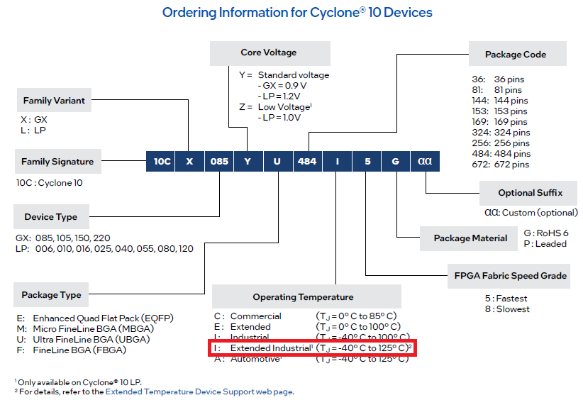

  • AqidAyman_Altera's avatar
    AqidAyman_Altera
    Hello MAC_Yossi,
    1. Refers to this KDB, it mentions that there is no difference between Industrial and Extended Industrial in device OPN. Both will be used "I" as the letter to indicate the Operating Temperature.

    Hi AqidAyman_Altera,
    I could Not completely understand that there is no difference between Industrial and Extended Industrial in device OPN. Please let us know your answer to questions below.
    Q1-1. If so, we have to order Industrial Grade product in device OPN and develop the design after setting Extended Industrial Grade (-40degC to +125degC) on Quartus Standard Edition. Is it correct?

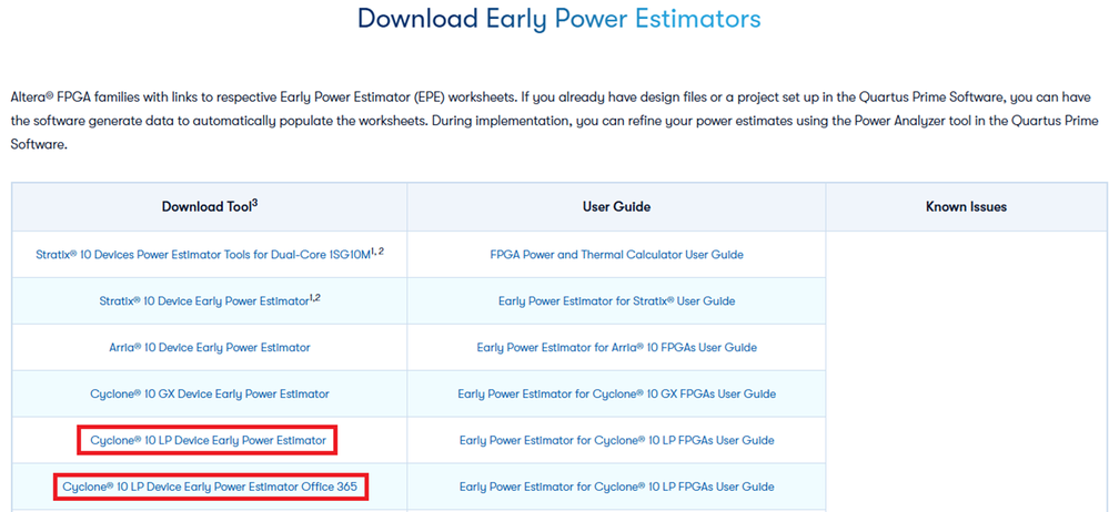

    2. If the device OPN is listed as Extended Industrial grade, then you may choose the same OPN in EPE.
         I keep trying to download the Cyclone 10 LP EPE, but I get an error below. Can you download it? If yes, please share it.

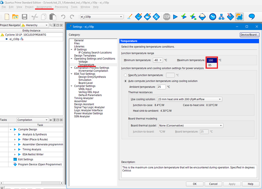

    3. After selecting the device, if the device is supported for Extended Industrial grade, you may check it on Assignments - > Settings -> Temperature. This is the example for 21.1 Standard version:
     I checked with the latest Quartus Standard Edition v25.1, but I could not set it to +125degC.

      Regarding the broken link inside the KDB has been reported internally. I will inform you once there is any updates on this.
      For the Cyclone 10 LP EPE download error, I also observed the same problem. This problem has been acknowledged internally. I will update you back once get any updates.

  • FvM's avatar
    FvM
    have no problems to set 125 °C maximum temperature for 10CL010YM164I7G, in Quartus Lite oder Std version, e.g. 19.1, 24.1 25.1
    Frank
    • MAC_Yossi's avatar
      MAC_Yossi
      Hi Frank
      From your comment, I understand that 125 °C maximum temperature for 10CL010YM164I7G can be set in Quartus Lite/Std version, e.g. 19.1, 24.1 25.1.
      But, in my environment it is impossible setting 125 °C maximum temperature because there is no 125 °C on window as shown in attached capture.
      Would you tell me how to set 125 °C?

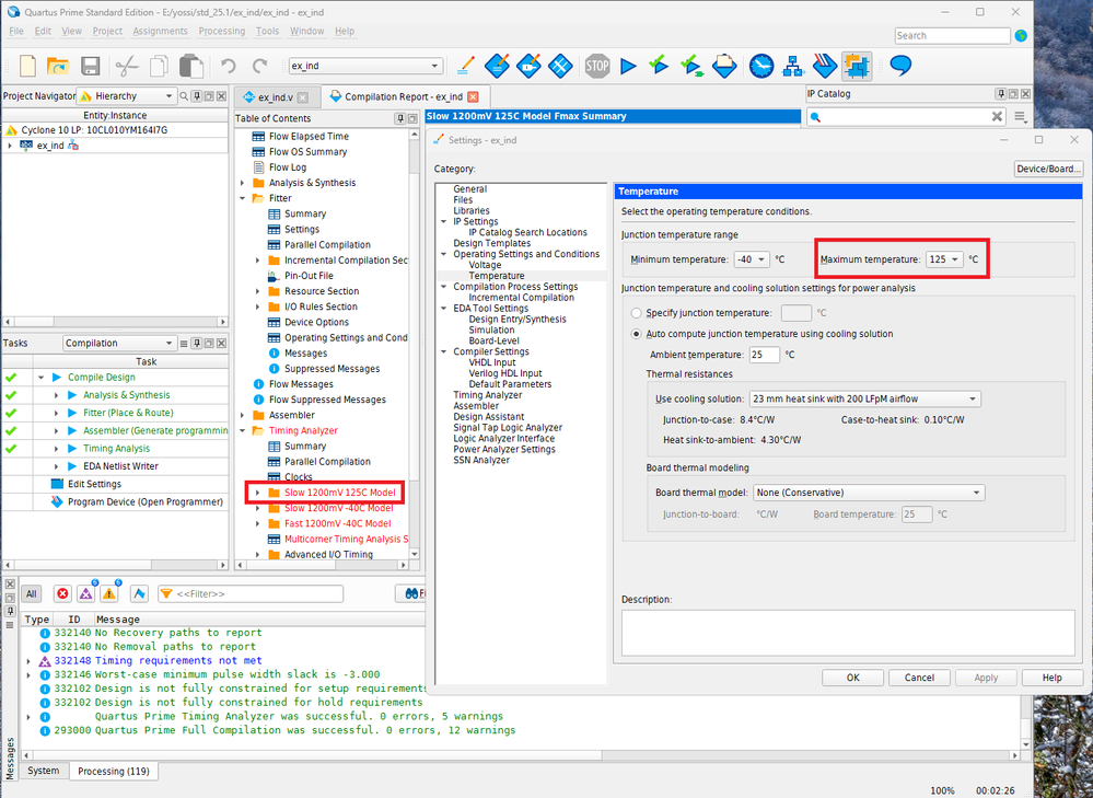

    Hi AqidAyman_Altera and Frank,
    I tried again with Standard Edition v25.1 and was able to set 125 C as shown below.
    Thank you for pointing it out.
    Captured data:
    From this result above, is the following my understanding correct?
    We can order Industrial Grade product in device OPN and develop the design after setting as same as Extended Industrial Grade (-40degC to +125degC) on Quartus Standard Edition.
    https://www.altera.com/design/resource/power/epe-and-pa#faq
