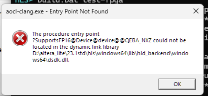

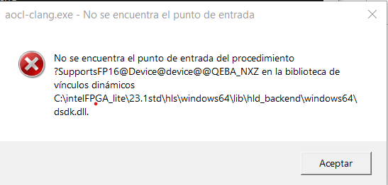

Launching the build.bat of an example in test-x86-64 mode returns the following error, translated below the image:
"The procedure entry point [...] could not be located in the dynamic link library [...]."
This also happens for mathlib.dll, generationlib.dll and mip_common.dll.

  • Thanks Noah. Please install Quartus 23.1lite, then add HLS as an 'upgrade', paying attention to step 3 of the Getting Started Guide. Make sure you remove/rename any version of HLS that exists in 23.1lite; I spoke with some people in engineering and the error you're seeing might appear if HLS 24.1 pro happens to pick up the libraries from HLS 23.1std.
