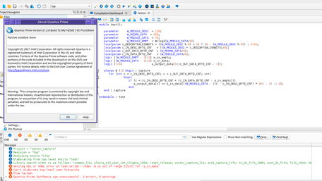

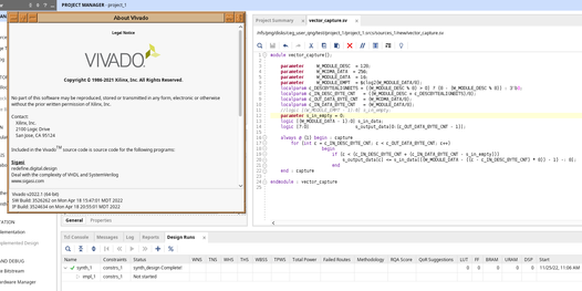

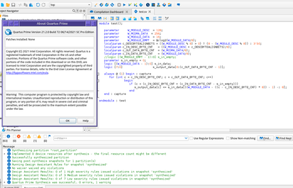

- ShengN_altera
Hi @Ranesh ,
I further create a test case with minimized code.
I'm getting synthesis error Error(13224): Verilog HDL or VHDL error at test.sv(19): index -8 is out of range [15:0] for 's_in_data' as you mentioned before in Quartus Pro v21.2 check image:
I further test with Vivado v2022.1. I'm also getting the similar synthesis error [Synth 8-524] part-select [-1:-8] out of range of prefix 's_in_data' check image:
I further found out that the root cause is at variable s_in_empty in module vector_capture.sv. You can't use logic type s_in_empty in for loop if statement. If change the type of variable s_in_empty from logic to for example parameter, both Quartus and Vivado can successfully synthesis the code check image:
Therefore, I believe this is expected behavior.
Sheng
