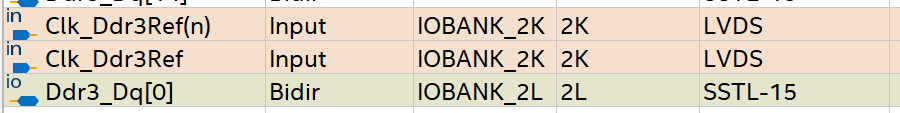

This error occurs even after I have stripped down my pin assignments to the absolute minimum. I only constrain the LVDS PLL reference clock to be in Bank 2K (which is an LVDS bank) and I constrain just one data bit to be in Bank 2L (which is a 3 V I/O bank). No other pin constraints are defined:

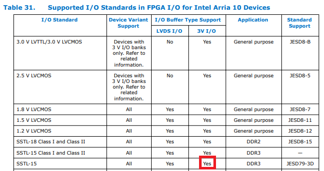

I have carefully checked Table 33 on p. 101 of the same document, which indicates that SSTL-15 should be supported in 3 V I/O banks:

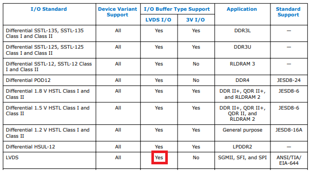

And, on p. 102, LVDS should be supported in LVDS I/O banks:

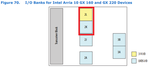

@AdzimZM_Intel I am trying to use Bank 2L and Bank 2K. As far as I understand, they are "adjacent" because they are next to each other in this diagram:

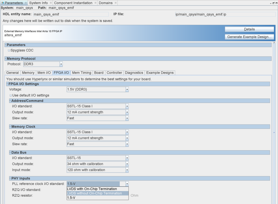

@AdzimZM_Intel How do I do that? The only option I can see related to on-chip termination in the EMIF IP is in FPGA I/O -> PHY Inputs:
Choosing either "LVDS with On-Chip Termination" or "LVDS without On-Chip Termination" seems to make no difference at all. The build still fails with the same errors.
