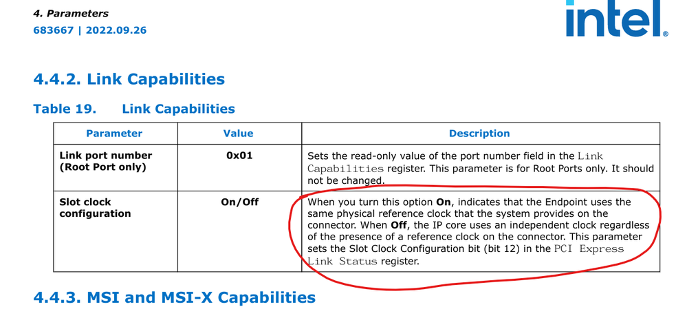

ug_s10_pcie_avmm-683667-666643 shows that The Intel L-/H-Tile Avalon-MM for PCI Express IP supports the Separate Reference Clock With No Spread Spectrum architecture (SRNS), but not the Separate Reference Clock With Independent Spread Spectrum architecture (SRIS).

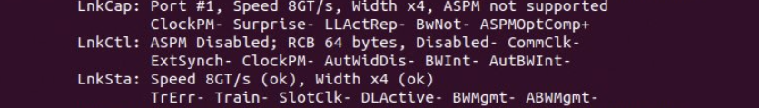

When I use the Common Clock Architecture (pcie reference clock come from the PC board through the Oculink interface), everything is normal and the example design can run successfully. But when I modify the pin constraints and use a 100M local clock from the FPGA board, Linux kernel will continue to print errors and the example design cannot run normally.

Yes, when using the separate clock architecture, users must set the Slot Clock Configuration to "off" in the Quartus IP Parameter. Could you also confirm that the RP side of the link has disabled the spread spectrum?

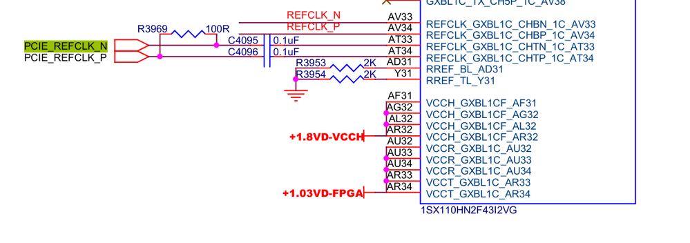

Could you please ensure that the reference clock (AT33, AT34) has 100 MHz ±300 ppm according to the PCI Express Card Electromechanical Specification Revision 2.0. The input reference clock must be stable and free-running at device power-up for proper PLL calibrations and a successful configuration.
Besides, where is the other refclk, and what are the pin assignments for refclk 0 and refclk 1 in both cases?

In UG, it can be seen that when using an independent reference clock, the slot clock configuration should be set to OFF, but I do this, the situation did not change much.

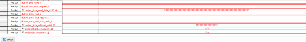

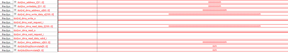

When I use the second set of parameter clocks, PCIe cannot establish a link, and ltssmstate changes between 2 and 3 several times, eventually staying at 2.

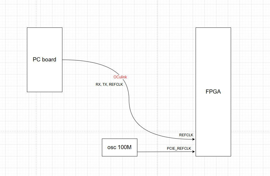

Hi ventt,
My reference clock comes from a crystal oscillator, which has a frequency of 100MHz , not the OSC-IN pin, OSC-IN connected to another 125MHz crystal oscillator.
As shown in the figure, AV33,AV34,The common clock, connected to PC board via oculink. AT33, AT34 come from a crystal oscillator on FPGA board. AV33,AV34, This set of clocks is working normally. If I connect to AT33, AT34, Will not work properly and print errors.
Please help investigating why the latter set of clocks is not working properly.
