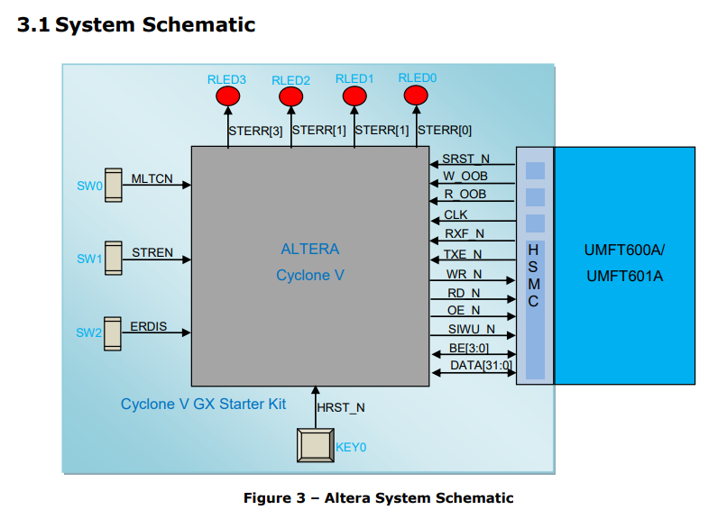

I am trying to interface the FTDI601 USB Bridge (https://ftdichip.com/products/ft601q-b/) to the Stratix 10 1SG10MHN3F74C2LG_U1/U2 FPGA on our design board. The reference clock for the interface is comes from the FTDI chip along with data/command signals. The signal RXF_N that indicates data coming from the FTDI chip appears one cycle wider when looked through signaltap on Stratix 10. The signal is asserted (active low) a cycle before the valid data.
To verify that the software driving the FTDI chip and interface to FPGA is correct, We tested the example designs based on Cyclone V (https://ftdichip.com/wp-content/uploads/2024/08/cyclonev_mst_fifo32_1.2.zip) provided by FTDI (https://ftdichip.com/wp-content/uploads/2020/07/AN_421_FIFO_Bus_Master_For-FT60x.pdf).
The design waveform as seen on signaltap is correct and the terminal data reading for the loopback design but for Stratix 10 has the RXF_N signal is wider (asserted one cycle earlier than data)
For the working cyclone design the FTDI chip and the Cyclone V FPGA are on the same evaluation board (https://www.terasic.com.tw/cgi-bin/page/archive.pl?Language=English&CategoryNo=165&No=830) and have a direct connection on board.
For our design we have the FTDI board (https://ftdichip.com/products/umft601a-b/) with HSMC adapter connected to the Stratix 10 FPGA through an adapter board and connector on the FPGA. The image of the adapter is attached.
I have attached signaltap image for both cyclone and Stratix.
Please help figure what could cause the widening of RXF_N on Stratix device. The same loopback design and software is used on the same FTDI chip.
