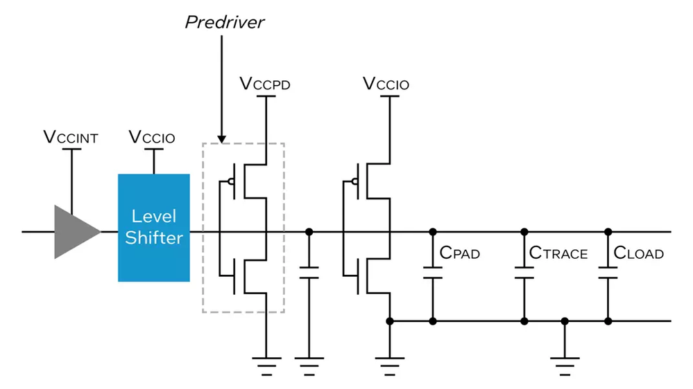

1.2 to 1.5 is 300mV can't explain how could it reach that level. - FvM
I don't expect that this (apparently flawed, unclear transistor gate/source connection) principle schematic is helping to identify possible leakage paths between VCCPD and VCCIO node.
Not sure what you are trying to achieve, why has VCCIO 1.2 V supply high impedance in your design? Is there anything against applying a moderate pull-down resistor, e.g. 1k at VCCIO 1.2V rail?
