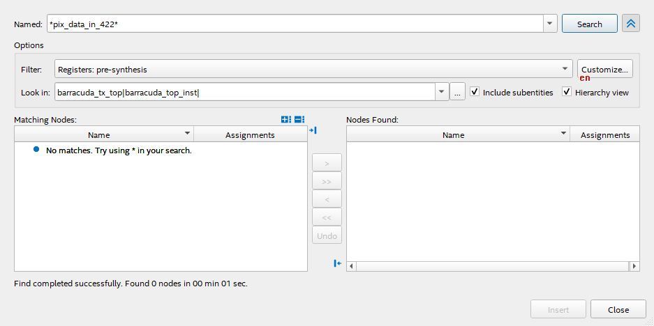

      Here is the filter I applied in SignalTap:

    You can find any signal that mentioned in your rtl in the filter, choose pre-syn if the wire is removed

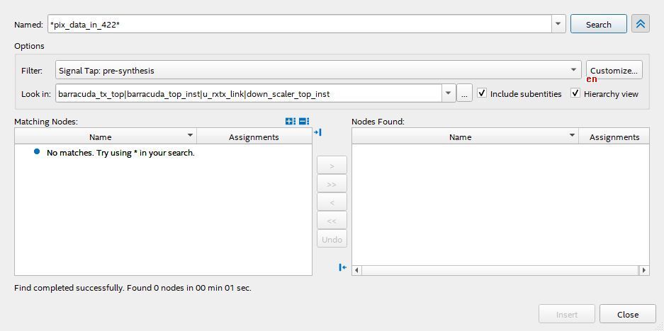

      Also with the per-synthesis filter, SignalTap cannot find the signal:

    Just to verify, you've at least run Analysis & Elaboration, if not full synthesis, before trying to use this filter, correct?

    Have you tried erasing the "Look in" setting in the filter? Perhaps you are searching the wrong part of your design hierarchy. Just delete that to try to search the entire design. it's got to be there.
