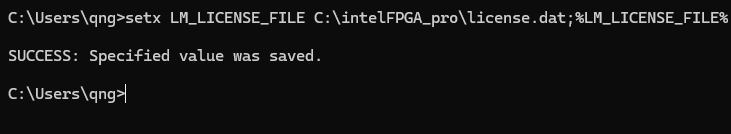

I'm ok without the space one. Check screenshot:

Okay, somehow despite the fact I did try it without a space before, I tried it again, and I got the same success dialog you did. However, upon trying to start Questa again:

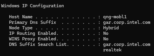

Your Host Name is DJDEADNUTS?
Possible to provide the Host Name like stated in screenshot below:
