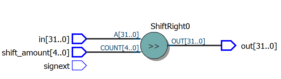

Quartus 12.1 Verilog bug: $signed() with >>> operation is ineffective.
module test(
    input wire [31:0] in,
    input wire [4:0] shift_amount,
    input wire signext,
    output wire [31:0] out
assign out = signext ? ($signed(in) >>> shift_amount) : (in >> shift_amount);
endmodule
	Warning (15610): No output dependent on input pin "signext"
Version: Quartus 12.1 64-bit on Windows 10; 13.1.0 Build 162 10/23/2013 SJ Full Version

      It's no bug.
      IEEE 1800-2017, 11.4.10 Shift operators specifies:
      The arithmetic right shift shall fill the vacated bit positions with zeros if the result type is unsigned. It shall fill the vacated bit positions with the value of the most significant (i.e., sign) bit of the left operand if the result type is signed. (...) The result signedness is determined by the left-hand operand and the remainder of the expression, as outlined in 11.8.1.
      As the result type in example is unsigned, the observed behaviour is correct.

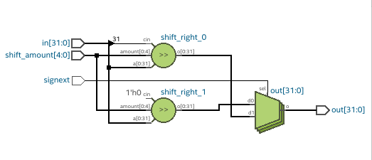

  • ShengN_altera's avatar
    ShengN_altera
    Based on the statement provided by FvM, have to do modification to the code like below:
    module test(
    input wire signed [31:0] in,
    input wire signext,
    output wire signed [31:0] out
    endmodule
    RTL viewer:
    Sheng
