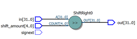

2 years agoQuartus 12.1 Verilog bug: $signed() with >>> operation is ineffective.
module test(
input wire [31:0] in,
input wire [4:0] shift_amount,
input wire signext,
output wire [31:0] out
assign out = signext ? ($signed(in) >>> shift_amount) : (in >> shift...
