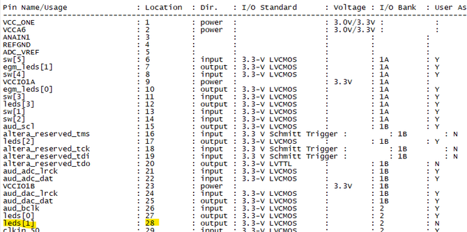

- CKPope
Here is the portion of the Fitter report for the design after employing the work-around change with the .tcl file:
As I mentioned, the compile completes after the auto-placement and the download to the FPGA on our board works as intended.
Thank you everyone for your discussions on this matter.
