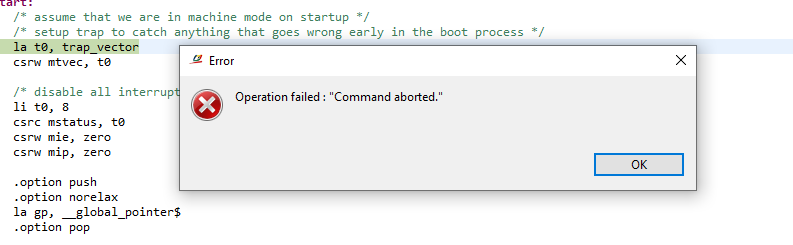

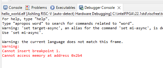

Also I tried today to run the ELF in Debug mode, to verify where the NIOSV is getting stuck. On running through Debug Mode, it prompted me to Error : Operation failed : "Command Aborted". Below are the snapshots of error and warnings of Debugger console.
It seems that ELF is loaded successfully into SDRAM, but when trying to read the code from a particular address, it is getting stucked due to unknown reasons.
Any help regarding this could be appreciated. Thanks !!

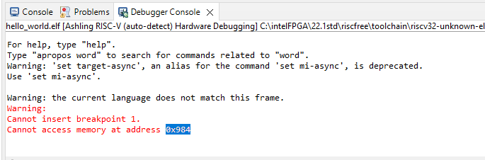

Also the Debugger Console shows the warning : "Cannot access memory at address 0x2cc" - To which I want to make sure that is NIOSV processor capable to run through the external SDRAM ? If yes, It would be great if I can get a reference design to run NIOSV Code through external SDRAM.

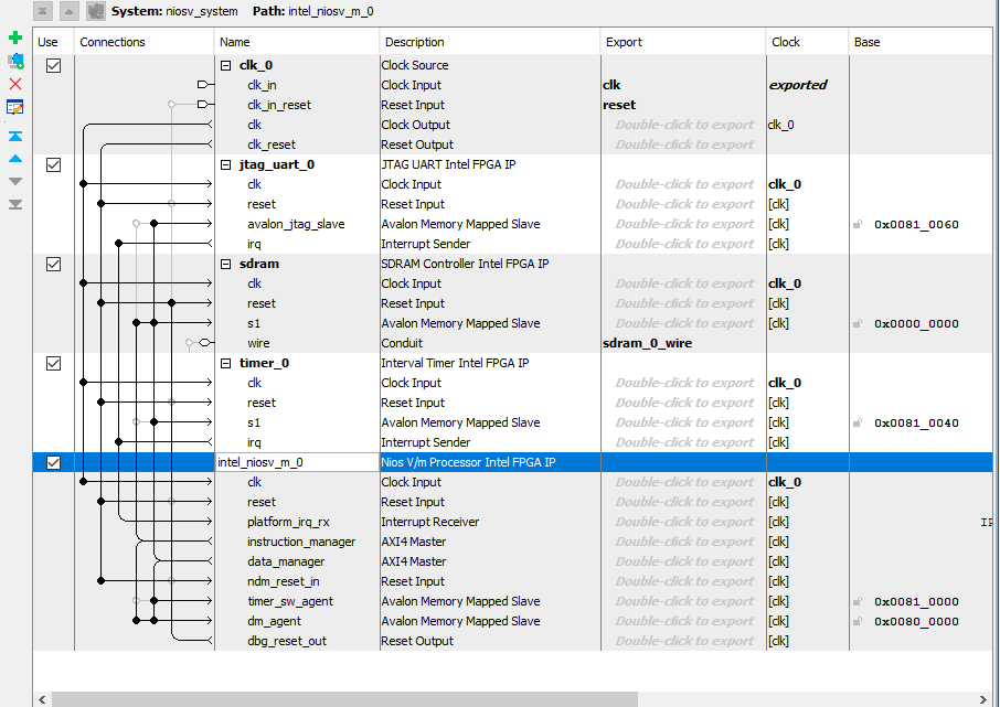

Unfortunately, we do not have a design example for External SDRAM running on NIOS V for your reference.
Also, may you check whether the Debug Module reset for NIOS V is connected to the external SDRAM? I will attach a picture of an example for this qsys connection.
Thank you and looking forward to your feedback.

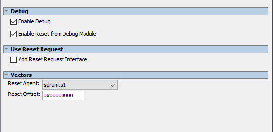

- himanshuvaria
I have verified that the Debug Module reset for NIOSV is connected to the external SDRAM. Please have a look at the below image for my QSYS configuration.
NIOSV configurations:-
With the above configuration, The NIOSV Code is able to get downloaded into SDRAM without RUN configuration failure in normal mode. But, still it gives me the same pop up error while running the ELF in Debug Mode. Error : Operation failed : "Command Aborted".
Debugger Console warning : "Cannot access memory at address 0x984"
Can you please elaborate in detail for the root cause of such issue ? I am again asking just to confirm that can we run NIOSV through external SDRAM ? If yes, then we can debug further with the hardware design perspective.

- KellyJialin_Goh
Thank you for the information provided. Running NIOS V through external SDRAM should be possible.
Could you try to make the connection between "dbg_reset_out" to "ndm_reset_in" ? I will attach a screenshot on this qsys connection.
Also, could you try to use niosv-download command to try downloading elf to run the application and lowering the JTAG frequency to 6Mhz to check whether is it a RiscFree issue.

- KellyJialin_Goh
Attached below is a screenshot of the qsys connection between "dbg_reset_out" to "ndm_reset_in" for your reference. You may connect it as of below to the NIOS V ndm_reset_in , external sdram and jtag's reset.
Thank you and looking forward to your feedback after trying the debugging steps.

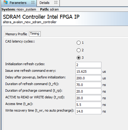

- himanshuvaria
Below is the snap shot of my SDRAM Controller IP configurations. Please have a look and verify if the configurations are correct for Cyclone IV E (EP4CE40F23C8).
Himanshu

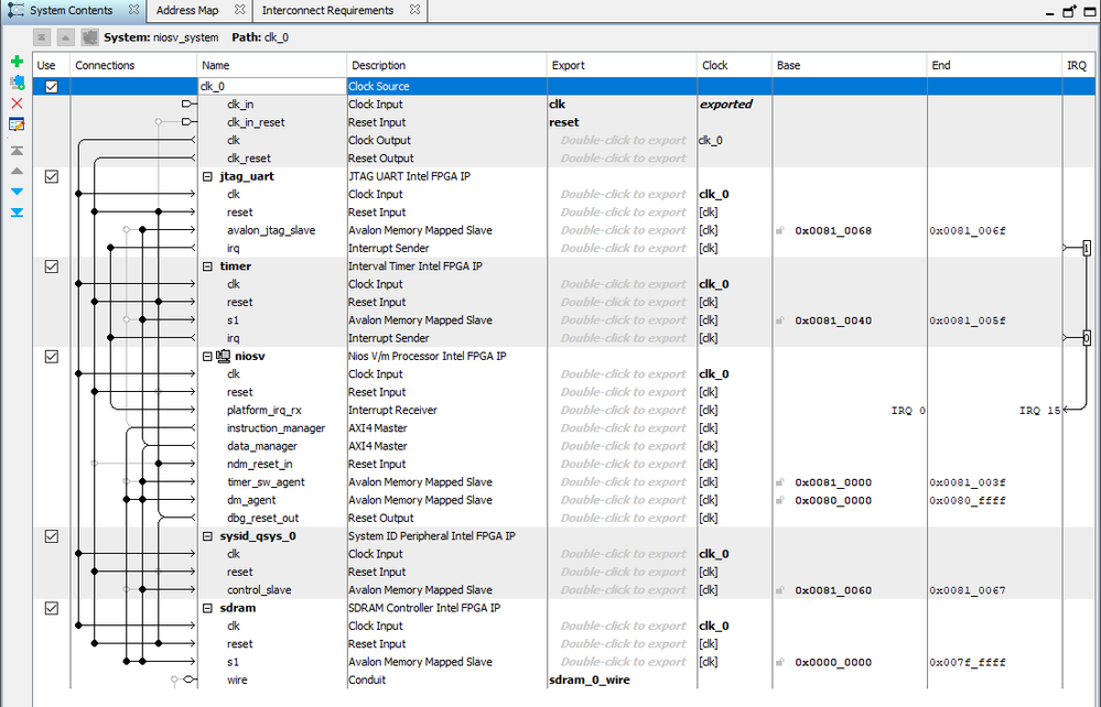

- himanshuvaria
Also I would like to mention some related information regarding the issues. The SDRAM consists 16 bit data bus while the data bus of NIOSV bus is 32 bits. Although the tool should be able to manage both the interfaces on its own, but to verify I created another simple design where I used On-Chip-Ram as program memory with 16 bits data width. Now my NIOSV code should work with 16 bit On-Chip-Ram but somehow I faced the same issue which I was facing while using external SDRAM as program memory. The NIOSV ELF gets loaded successfully without Run Failure but does not get executed. While running through Debug("Ashling RISCV (auto-detect) hardware debugging option), I faced the similar issues as I was facing for external SDRAM. The Debugger console shows the warning, "Cannot Access memory at address 0x2b4".
I am attaching the design here for your reference. Please have a look and give your feedback !!
Can NIOSV run with 16 bit On-Chip-Ram. If yes, then why it is resulting in such kind of errors. Only if I change the data width of On-Chip-Ram to 32 bits, everything works fine. But with 16 bit, it is having issues while accessing the code. I think similar issues were there with SDRAM as the data bus of SDRAM is 16 bits.
Please find a solution regarding this. Thanks !!

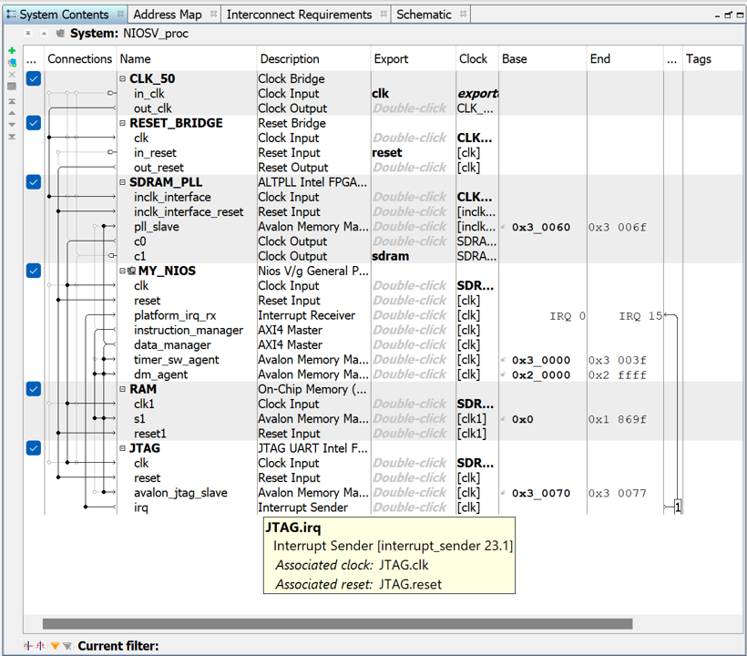

- Vincent_F
Hi Kelly,
I've also been trying to run a Nios V system on a DE10-Lite board (MAX 10 device). I implemented a very simple Hello World project. Everything goes fine when I use the default on-board clock (50 MHz) and the on-chip memory. But, like Himanshu, the system fails to run when using the SDRAM instead of the on-chip memory. The SDRAM requires a PLL for both overclocking (100 MHz) and appropriate timing, so I simply used the same PLL and configuration as for a Nios II project.
Then, I noticed that the Nios V system does not work with a 100 MHz PLL (using on-chip ram only). When configuring the PLL at 50 MHz, everything works fine again (still with on-chip ram only).
Did I miss something while configuring my system, or is there an issue with overclocking the Nios V?
Below is a screenshot of my Platform Designer system for the Nios V configuration.

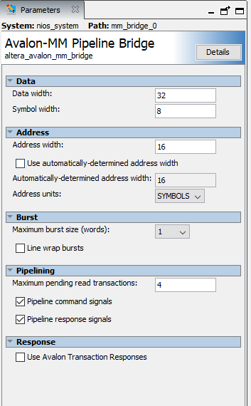

- himanshuvaria
Hi Vincent,
I would like to advice you to add a Avalon MM Pipeline Bridge IP between SDRAM Controller and NIOSV Processor. By doing this you would be able to run software from SDRAM. Below is the configuration of Avalon MM Pipeline Bridge for your reference.
The MASTER Interface of Avalon MM Pipeline Bridge IP must be connected to SDRAM Controller IP and the SLAVE Interface of Avalon MM Pipeline Bridge IP must be connected to NIOSV Processor.
I hope by doing the above change, you will be able to run your software through SDRAM.
