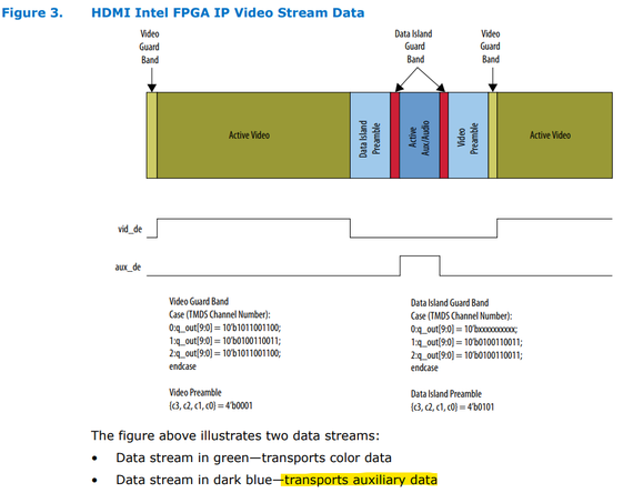

DRMI packets are part of the Auxiliary data. These data is place in packets and transferred using 3 main data channel.
HDMI Video Stream Data

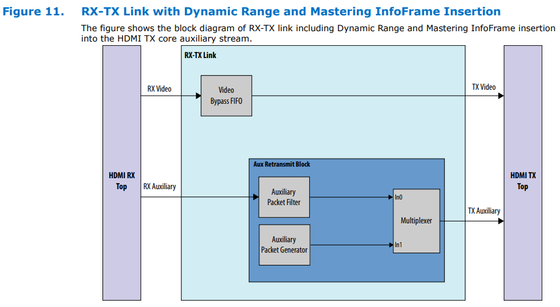

The reason that you are getting a constant value could be due to filtering mode.
In this case, when your source is transmitting the payload, the Aux packet filter the payload, and use the payload generated by the Aux packet generator.
Rx-Tx Link with DRMI

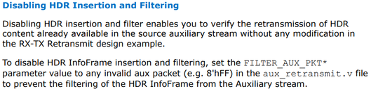

There is a way to disable this filter as shown in picture below:
Disabling HDR Insertion and Filtering
You may refer to below link for more information on said above:

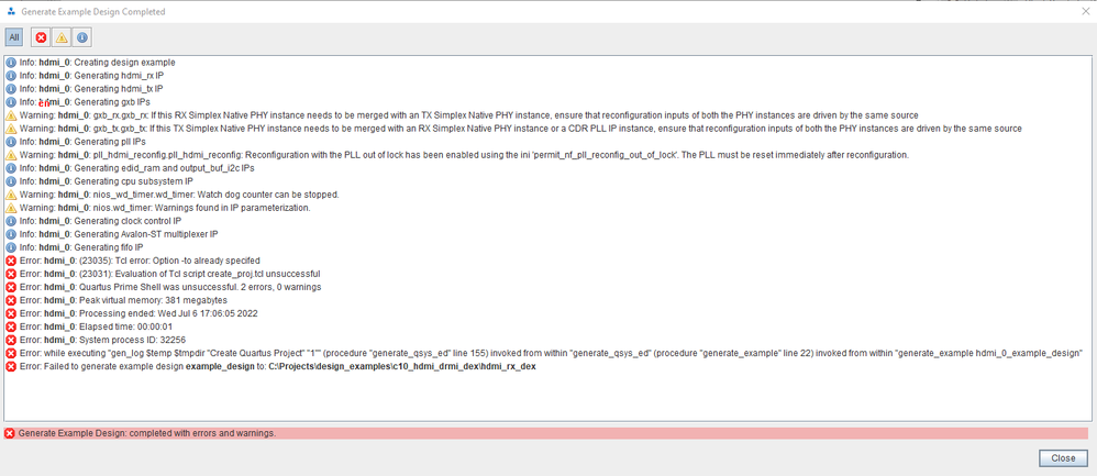

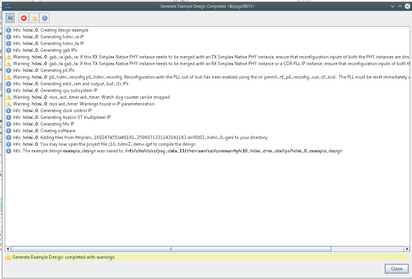

I've tried to generate the HDMI IP Design Example, but the generation has been failed with the following error:
Could you please help me with generation the HDMI Example Design for Quartus v19.3 ?
Attached please find the archived directory, where I tried to generate the Example Design.
Thank you!

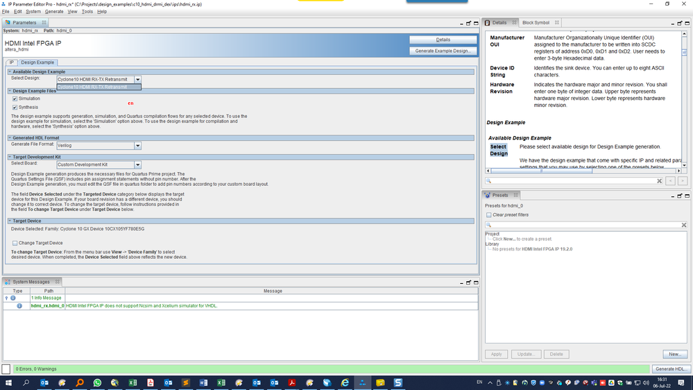

I've generated the HDMI Design Example for Cyclone-10, but the aux_retransmit.v file was not generated (not a part of the HDMI Example Design), so I cannot change there the FILTER_AUX_PKT* parameters there...
So, how to disable the HDR filtering if the mentioned file doesn't exist?

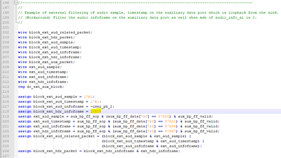

- ZH_Intel
Hi amildm,
Good day.
After further discussion with internal team, to passthrough HDR infoframe, you need to change below bit to 0 in the rxtx_link.v file located in the rtl folder.
rxtx_link.v file
Thank you.
ZulsyafiqH_Intel
- amildm
Contributor
Hi ZulsyafiqH_Intel,
Thanks a lot to your response.
I'll do the mentioned by you change and test the design on the board.
I'll return to the office next week, so please be patient until my response.
Thank you again,
- amildm
Contributor

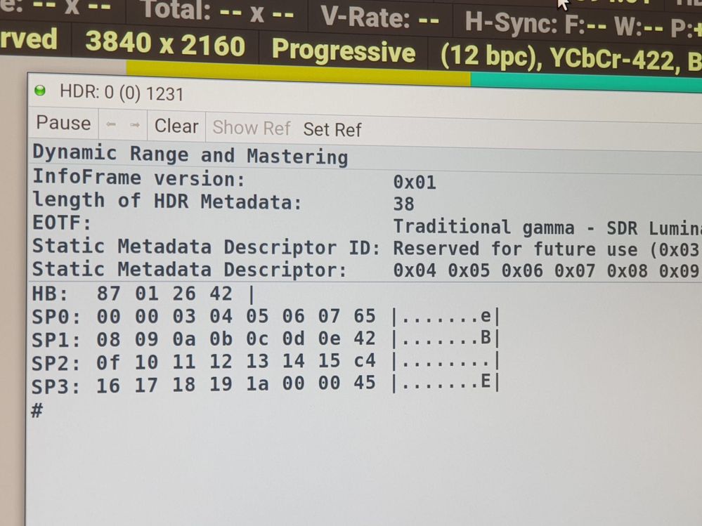

I've changed the mentioned block_ext_hdr_infoframe signal to drive '0', but still what's going out is the internally generated HDR metadata, not one which the video source sends.
Here is the HDR, which was received (captured by Quantum Data):
Should anything else be changed in the RTL in order to pass through the original DRMI frames with the original HDR metadata?
