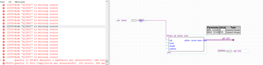

    So this is the message, I don't know since I'm begginer to it what to put on the output bus so to make it work and be able to analyze it in simulations.
    The code is the same (from the template binary up down counter)
  • sstrell's avatar
    sstrell
    What is the exact warning you are getting and can you show your code?

      Indeed I found it but I have warnings with the output saying can't find the node source.
      What should I put on the output of this counter?
