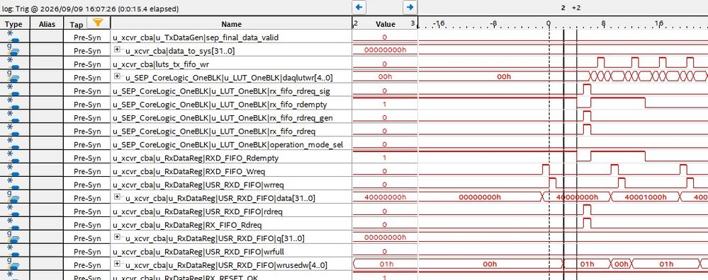

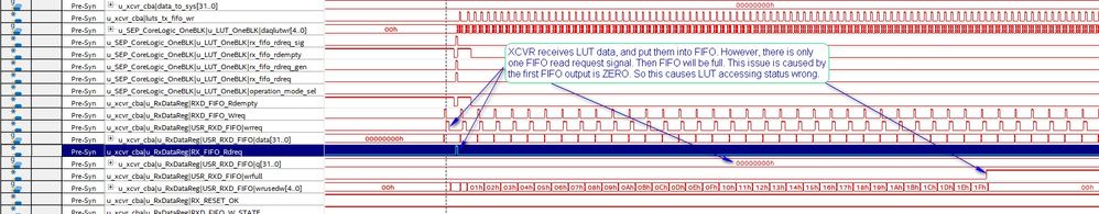

As the above image indicates, RX get data from XCVR and put them to FIFO. The write is ok, however, the reading has problem. Because the first read data is ZERO, this causes the following reads all halt.

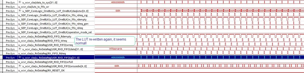

I apply one more same operation, now it's ok, as following image:
As above image indicates, one data is put into FIFO, and it will be read out from this FIFO in time.

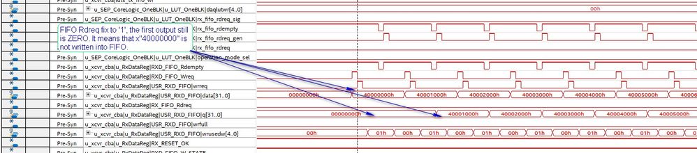

I did one test: FIFO's Rdreq is fix to high level. Then I got the following result:
As above image indicates, the first data x"40000000" can't be written into FIFO. So I always got ZERO for the first data. Buy how this can happen?  I kept detecting more deeply, as following image
As above image indicates, after Wreq valid, 2 clock cycles later, Usedw will change, and 2 more clock cycles later, empty signal will be changed to low level.
This is the problem. Usedw and empty signals are changed too fast. I checked normal timing, UsedW should be changed 3 clock cycles later after Wreq valid, and empty should be changed 5 clock cycles later after Wreq valid.
