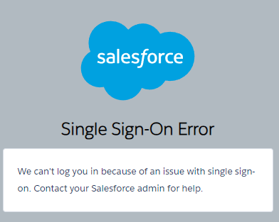

      I am unable to access the supporttickets.intel.com site. When I attempt to login, it accepts my email username, presents the azure login prompt which works with my new corporate SSO email and I get a prompt for the 2FA authentication code. After entering this code, I am presented with a simple page that reads:
      Salesforce
      Single Sign-Error
      We can't log you in because of an issue with single sign-on. Contact your Salesforce admin for help.
