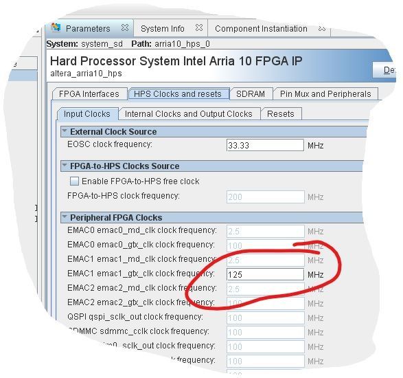

When I change the EMAC1 emac1_gtx_clk clock frequency into 125 MHz (tab "HPS Clocks and reset, Input Clocks") this frequency is not found in the hps.xml. This hps.xml file mentions the emac1_clk_hz frequency of 250 MHz which is (I assume) the value of the EMAC 1 clock frequency (tab "HPS Clocks and reset, Internal Clocks and Output Clocks").
Frank

A change in the EMAC 1 clock frequency (tab "HPS Clocks and reset, Internal Clocks and Output Clocks") is reflected in the hps.xml file. However, the tooling will give a warning: Warning: system_sd.arria10_hps_0: EMAC1 is in GMII/RGMII mode but has a 50MHz clock. 250MHz Clock is recommended. The result remains the same: gtx clock has a frequency of 250 MHz.
