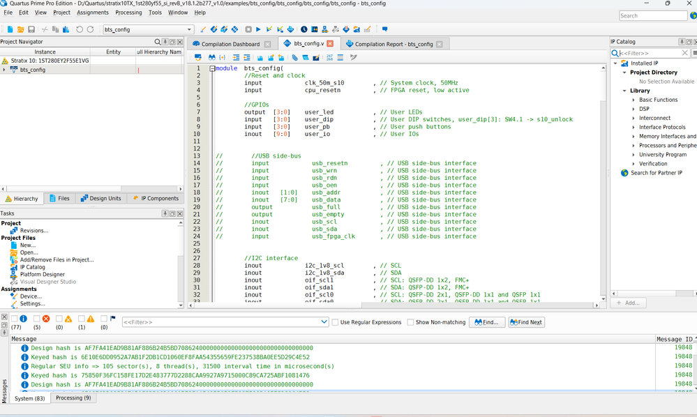

I have followed the documentation and found both qts_pam4_com and bts_pam4.sof. I’m currently in Quartus with the bts_config project open, but I’m stuck on how to proceed to the BTS main page → PAM4 tab.

You do not need to recompile
bts_configto run the loopback test. Thebts_pam4.sofis the pre-built programming file you should use directly. Here is the correct end-to-end sequence:Step 1 — Board Preparation

get_service_paths masterin System Console. To fix, reprogram U8 withmax5.pof, found in theexamples/max5folder of the development kit installer package. SEVERE: java.io.IOException: Get master service paths failed!In summary: usebts_pam4.sofdirectly, no need to recompilebts_config. The bts_config project in your screenshot is the source project for reference/modification; the installer-provided pre-built SOF is what the BTS GUI is designed to work with out of the box. - ai_responder
