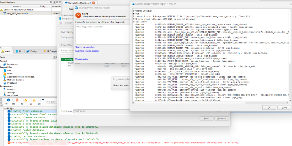

Why does the system report an error when generating rbf from sof files and fsbl files?
Error message:
Error: Internal Error: Sub-system: BITASM, File: /quartus/pgm/bitasm/bitasm_common_code.cpp, Line: 518 HPS data start address(-1950584) is not 16 aligned

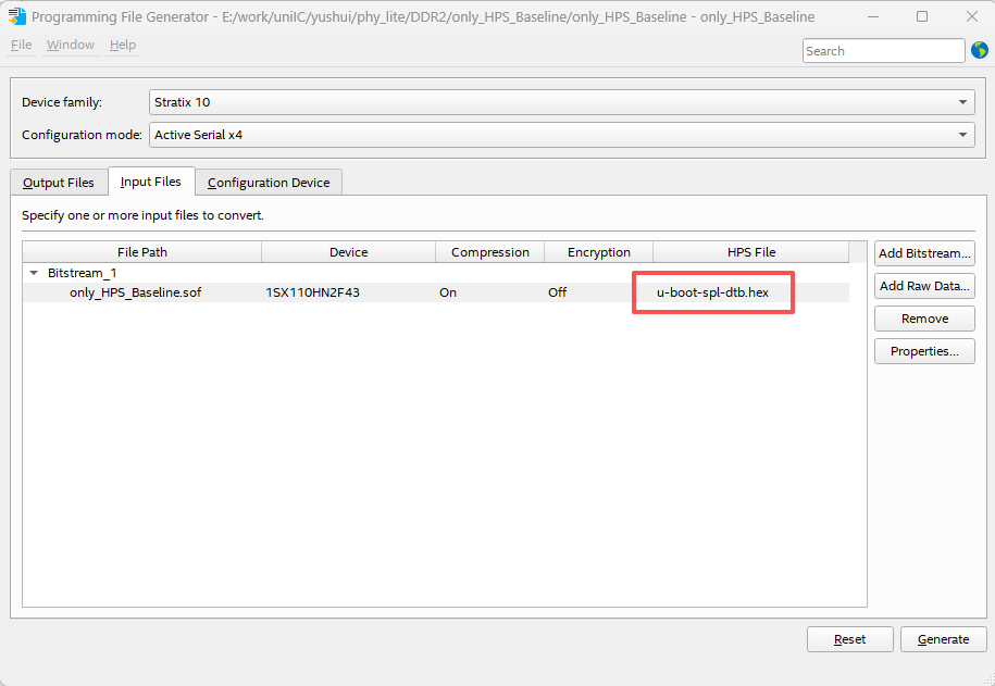

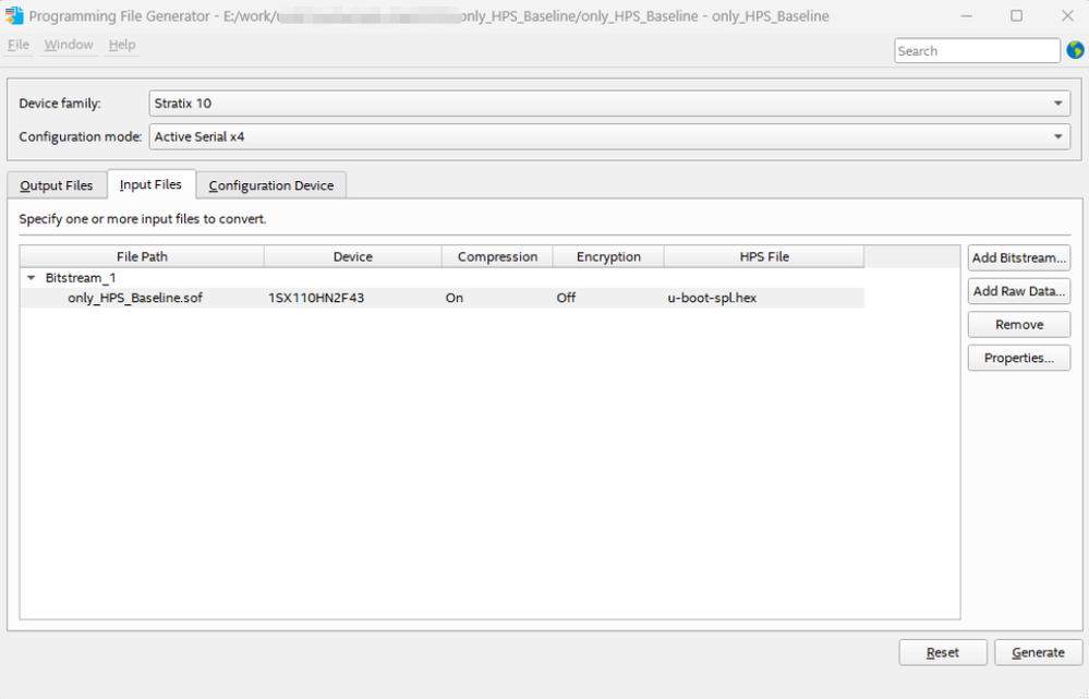

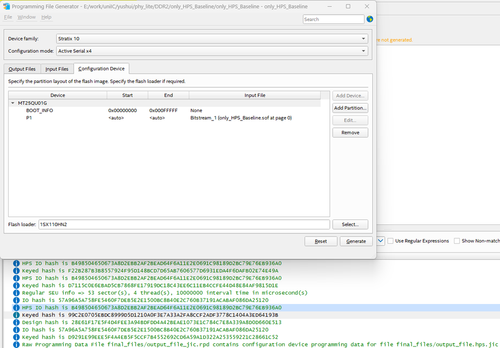

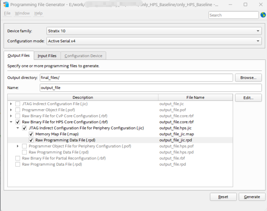

  7. Open the Programming File Generator tool and configure the Output Files:
  8.  Configure Input Files, add sof and HEX files:

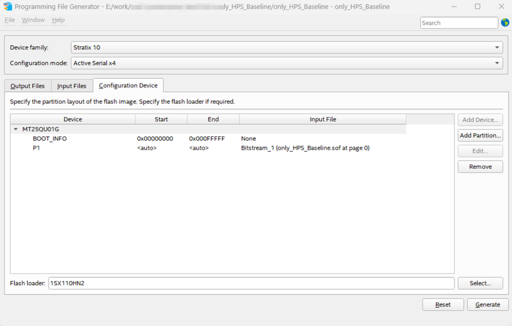

    9. Configuration Device:

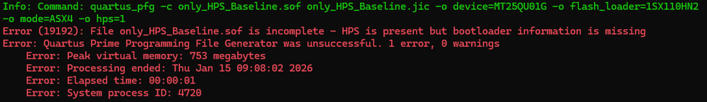

    10. Generate error:
