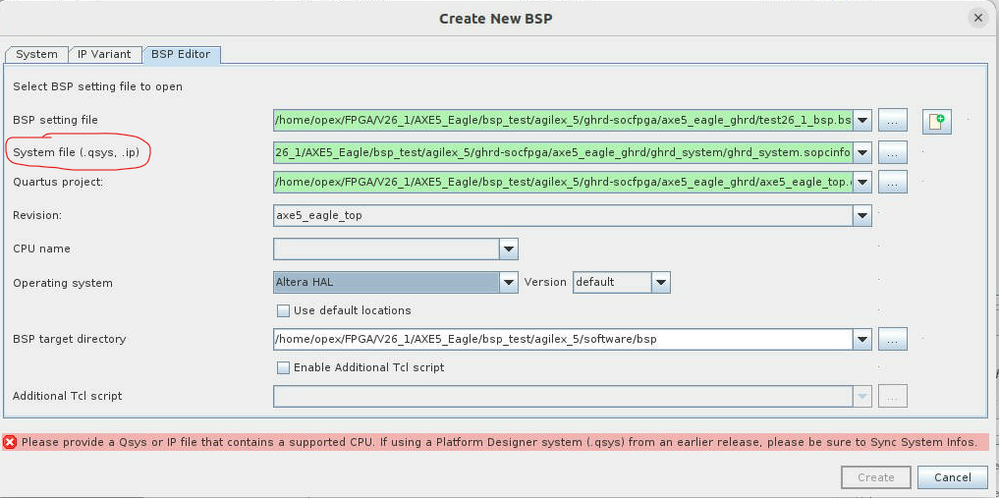

Hi, I am using Quartus 26.1 with the Agilex 5 Modular Development Kit (Device number: A5ED065BB32AE6SR0) and I have a few questions about BSP Generation for Hard Processor System (HPS).  For reference I am following the Quartus Prime Pro Edition Version 26.1 User Guide.
1. How do I generate Altera HAL for HPS? When I use the BSP Editor in platform designer, I can only generate the system.h file that only has macros for EMIF, even though other peripherals are also connected to the HPS. How do I generate macros for the H2F bridges and HAL API Files for the HPS?

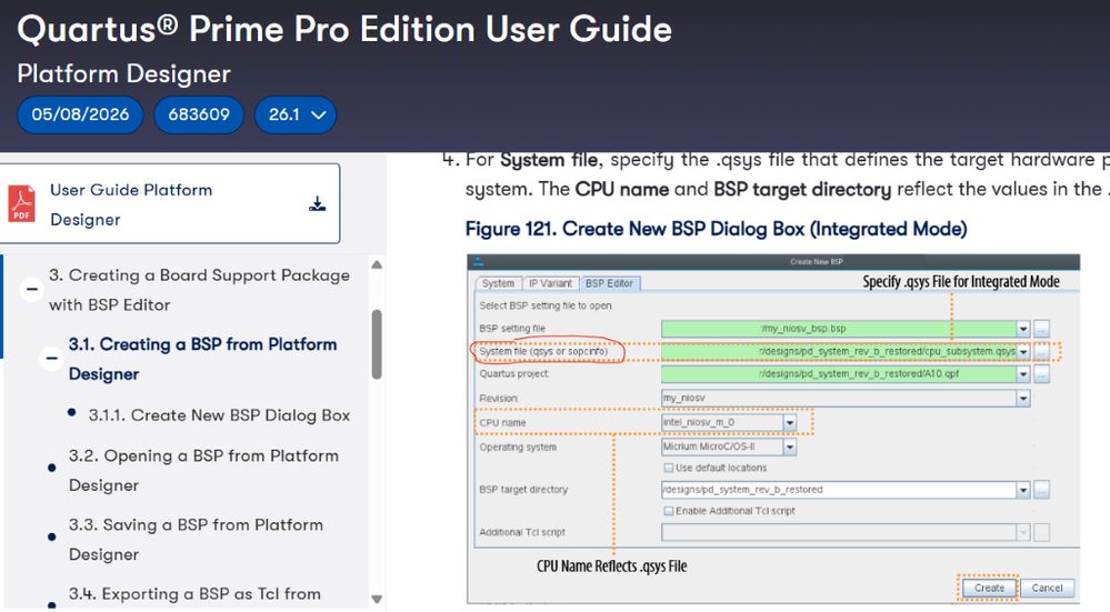

2. How do I input a SOPCINFO file into the BSP Editor? The Quartus Prime Pro Edition User Guide shows that I should be able to input SOPCINFO file as the system file (see above image) but Quartus only gives me the options of QSYS and IP file (see below image).

      On a side note, is there a reason why the BSP editor is not able to accept SOPCINFO files as the system file for Quartus version 26.1?
      Thank you again!
      • KelvinK_Altera's avatar
        KelvinK_Altera
        SOPCINFO files only can apply on Quartus Standard version of BSP editor.
        Quartus Pro version BSP editor not able to accept SOPCINFO, only qsys.file can be accept.
