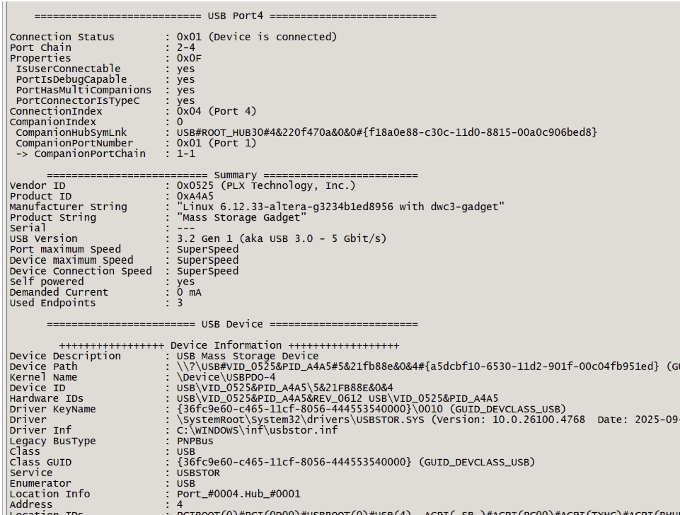

thanks for your question. I assume you are following our guide to enable USB 3.1 device mode on the Agilex™ 5 HPS for the Agilex™ 5 E-series premium devkit. Please note that this guide only started working in Quartus® Prime 25.1.1; not 25.1.
USB 3.1 Gen-1 Controller Tutorial Example Design User GuideHow can you tell that the Agilex™ 5 devkit is detected as USB 2.0? I checked the device using USBTreeView and it enumerated as USB 3.2 Gen 1 (which, confusingly, is basically the same thing as USB 3.1 Gen 1 and USB 3.0). Are you sure the upstream port you connected to supports USB 3.1?
