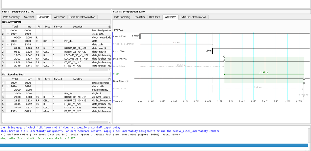

I was trying to simulate a simple circuit with Quartus, to use the Timing Analyzer for understand how the static timing analysis works.
I was wandering if there is a way to disable the optimization of the tool in order to remove the Data Delay and Clock Delay corrections (see the above picture) added by the tool to close the timing.

So you're talking about the Optimize Hold Timing setting. Delay is added to meet hold timing at the expense of some setup slack. Assignments menu -> Settings -> Compiler Settings -> Advanced Fitter Settings.

I think I explained myself poorly. I noticed that during compilation quartus has the ability to insert delays on the data and clock lines. I'm not sure how he manages to insert them, but he does it to try to close the timing. If I define via sdc for example "set input delay max/min" assuming that there is an external device that launches the data towards the fpga, quartus appropriately adds delays on the data/clock to be able to latch the data correctly. I was wondering if it was possible to eliminate this correction function..

do you agree that quartus has the ability to add delays to both data and clock? adding delay on the data improves the timing on the hold, does adding delay on the clock improve the timing on the setup?
Am I saying this right?

Optimize hold timing is for data paths only. For clocks, there used to be an option called Beneficial Skew that would intentionally add delay on the latch clock to improve setup slack (data can arrive later and still meet setup time).
I think this was removed at some point (I don't see it in my 23.3 Pro) because it wasn't good to have skew between the launch and latch clocks without user control. If you need skew like that, better to use a second PLL output (much more plentiful in newer devices than they used to be) and add a phase shift which you can set yourself.

Thanks again for your reply. I'm using Quartus Standard 22.1. On this version should I find an option to disable the skew between launch clock and latch clock that the tool automatically inserts to improve setup timing?

Not sure. Like I said, the setting was called Beneficial Skew. It's been gone for a while so that might be the case with Standard as well.

That setting still can be found in Advanced Fitter Settings for Standard version.
