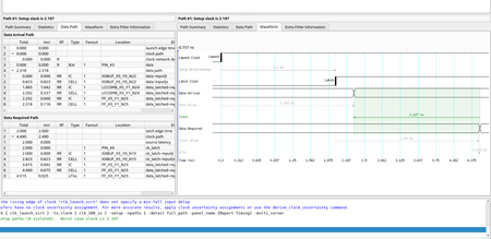

Hi, I was trying to simulate a simple circuit with Quartus, to use the Timing Analyzer for understand how the static timing analysis works. I was wandering if there is a way to disable the op...

do you agree that quartus has the ability to add delays to both data and clock? adding delay on the data improves the timing on the hold, does adding delay on the clock improve the timing on the setup?
Am I saying this right?
