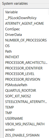

- RichardT_altera
That's an interesting finding — I wasn't aware that this specific variable setting could cause the issue.
I don’t have that variable set on my PC, so it's strange that it works in my case. But at least the solution works for you.
Here's my environment variable setup for reference.

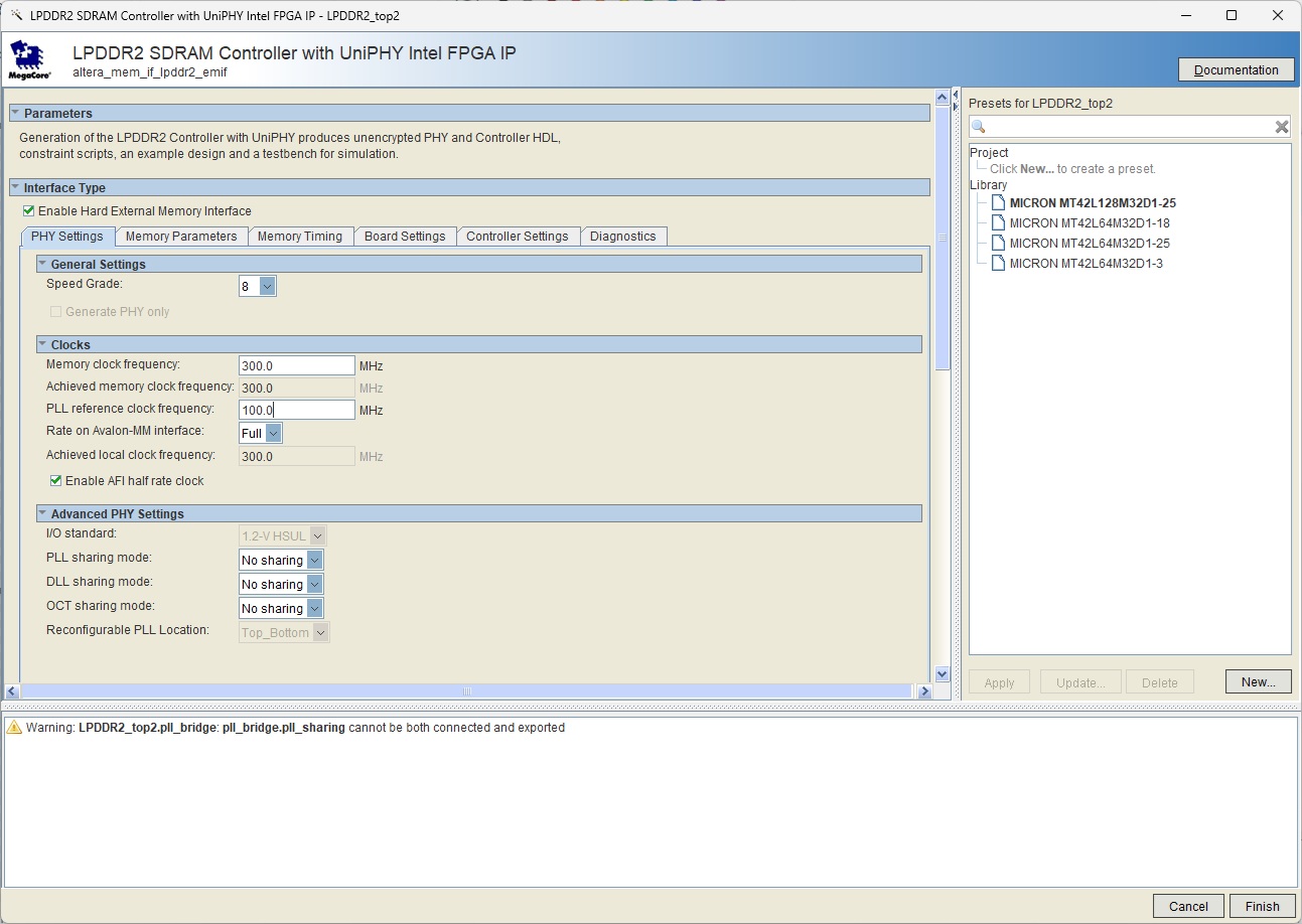

Can you show a screenshot? This should not be a requirement to add an EMIF to a design.
- Hidetaka
Hello, sstrell-san.
I am attaching a screenshot of the LPDDR2 MegaWizard settings.
I have also attached the error message I got when generating MegaWizerd.
I am planning to use nios V with the cyloneVGX "5CGXFC7D7F27C8N" and LPDDR2 implemented on this board.
I am having trouble generating the hardware memory controller included in this device.
Regards, Hidetaka.

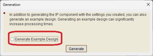

- Hidetaka
Hello, Richard-san.
When I saw the error message, the error was in the "Info: LPDDR2_top2: Generating example design" item,
so I thought maybe I just shouldn't generate the example design, so I ran it, and it was generated without any errors.
Error: Execution of script "/0008_LPDDR2_top2_gen/simulation/generate_sim_example_design.tcl" is causing an error,so I would appreciate it if you could fix this part.

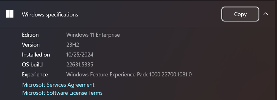

- RichardT_altera
Hi @Hidetaka
I would like to check with you —may I know which version of Windows 11 you’re using? Is it Windows 11 version 24H2 where you're encountering the error? I’m asking because another user has reported experiencing the same issue with Windows 11 24H2. With PLL IP instead of LPDDR2.
Regards,Richard Tan
