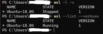

• Open a command prompt and type "wsl --list --verbose". You should get something like the following:
C:\Users\xxx> wsl --list --verbose

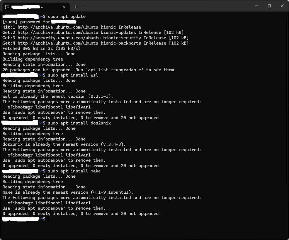

• Type wsl -u root to enter the Ubuntu terminal and issue the following commands
o apt update
o apt install wsl dos2unix make build-essential
Wait until the installation finishes.
After that, open Quartus and try generating the IP again.

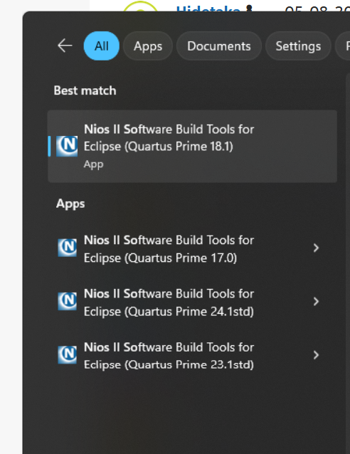

Another thing that is different from what you did is that I do not install the Nios II SBT for Eclipse separately.
It comes along when I installed the Quartus.
As you can see in the picture, I have a few Quartus versions installed in my laptop with different Nios II version respectively.
So perhaps try to uninstall the Nios II SBT for Eclipse.

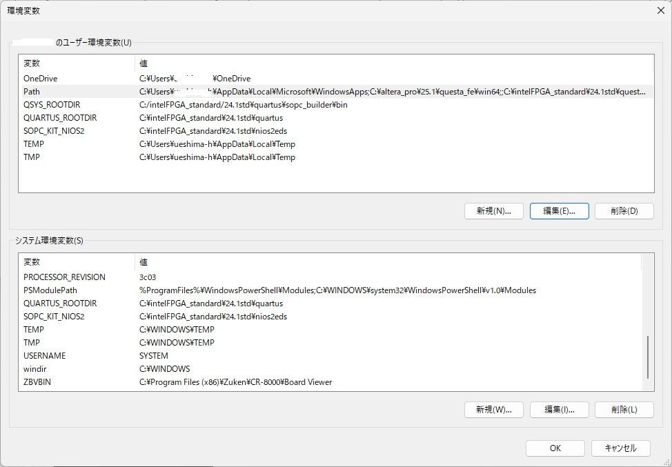

Or maybe install the Quartus v23.1std and see if the IP generation in v24.1 works.If so, I suspect the environment variable settings might be the issue since I have a few Quartus version installed.

Hello, Richard-san.
I additionally reran the following:But the result was the same.
Only Quartus Prime standard 24.1.0.1077 and Quartus Pro 25.1.0.129 are installed on my PC.
Is the difference that I installed CDT 8.8.1 additionally?
https://www.intel.com/content/www/us/en/support/programmable/articles/000086893.html
I don't think it's a problem with the windows environment variables.I have not yet run it in an environment where CDT 8.8.1 for Windows has been removed. I will try it tomorrow.
