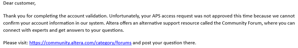

    Trying to get 'Altera Premier Support' to resolve this also doesn't seem to work, as Altera doesn't seem to be able to confirm my account information.

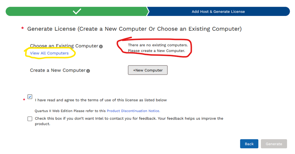

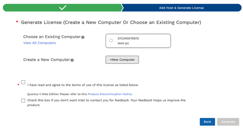

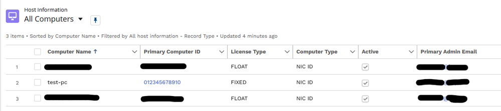

    OK, I tried this, but when I get to the following page and want to choose an existing computer, it says "There are no existing computers." (encircled in red)
    But then when I click "View All Computers" (encircled in yellow),
    the browser opens a new webpage which does lists all of my computers.
    See 2nd screenshot.
    So on the first web-page, I simply cannot click 'Generate' because I cannot select a computer there.
    I guess the problem might be caused (again) because I have 2 mail addresses for my mailbox,
    and the 'Primary Admin Email' is registered to 1 mail address, while my login for my Intel account (Microsoft Azure) uses the other mail address.  This has been a problem before, but our IT department apparently is unable to fix this.
    When I try to login to Azure with my Primary Admin Email address, it doesn't allow me to do that.

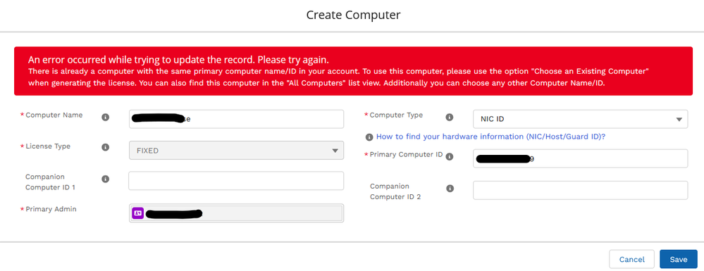

    And when I try to add a "New Computer" and enter the information of my already existing computer,
    I get an error message saying that this computer already exists...
    • ShengN_altera's avatar
      ShengN_altera
      Try to edit the existing computer host name to other name. Then create a new computer. Does it shows up?

    "Try to edit the existing computer host name to other name."
    That doesn't work :

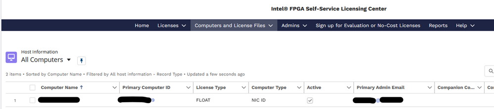

    Creating a 'new computer' from this page works :
    and then that PC also shows up in my list of computers :
    So it is really weird that I can't select one of my existing computers on the "Generate license" page...

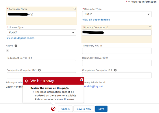

    Is there some way for you to increase the number of rehosts available on my 2 Quartus Prime Pro licenses from 0 to 2 ?  That would allow me to rename the existing host, and then create a new one and move all the licenses over.
      • ZatK's avatar
        ZatK
        Ok, I tried this as well, but my original server is a 'FLOAT' server,
        so apparently I cannot move this license to that server ?

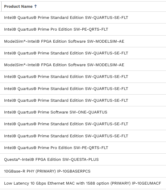

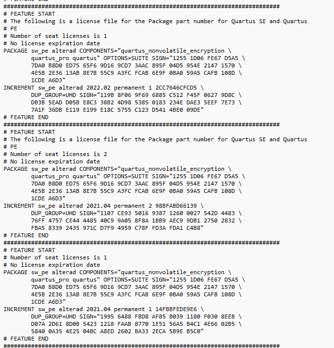

    Here is a list of the licenses which I now have :
    Below you can see a part of the generated license file, which shows Quartus SE / Quartus PE licenses.
