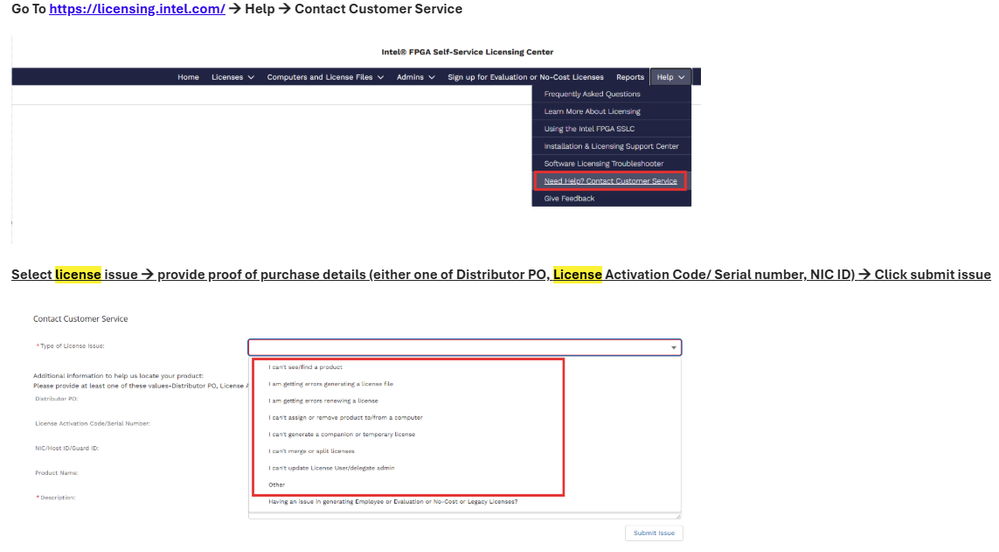

- ShengN_altera7 months ago
Purchased license needs to file the internal ticket through the step below:
- ZatK7 months ago
I already submitted a case with Intel Support earlier, but said for licensing issues I should post on this forum. So that is what I did.
I think previously you're requesting Questa Starter Edition license, that's why you can't file the internal ticket.
Could you try to submit the new ticket and mention purchased license SW-QUARTUS-SE-FLT and SW-PE-QRTS-FLT?
