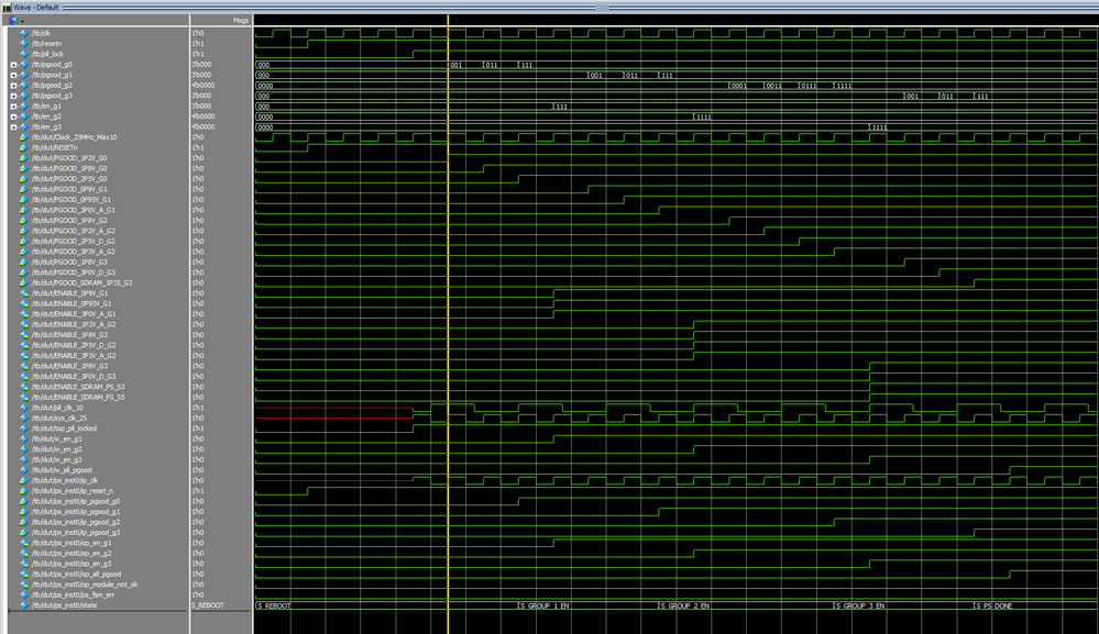

      I can try that, but I haven't had an issue combining state and output logic in the past. When I simulate the design as-is the logic works fine.
      (hopefully this snapshot is readable when uploaded)

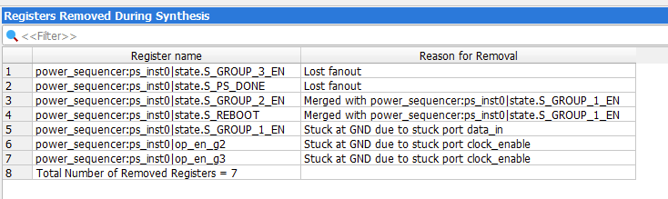

      Under optimization results I see:

      It turns out that my issue was caused by using 'x in my typedef state enum after all.
      Something must have changed, or this project's settings are slightly different in some way because I have used this construct successfully before.
      typedef enum logic [4:0] {
      S_REBOOT = 5'b0_0001,
      S_GROUP_1_EN = 5'b0_0010,
      S_GROUP_2_EN = 5'b0_0100,
      S_GROUP_3_EN = 5'b0_1000,
      S_PS_DONE = 5'b1_0000,
      S_FSM_ERROR = 'x <-- Removing this fixed my issue.
      } state_e;
