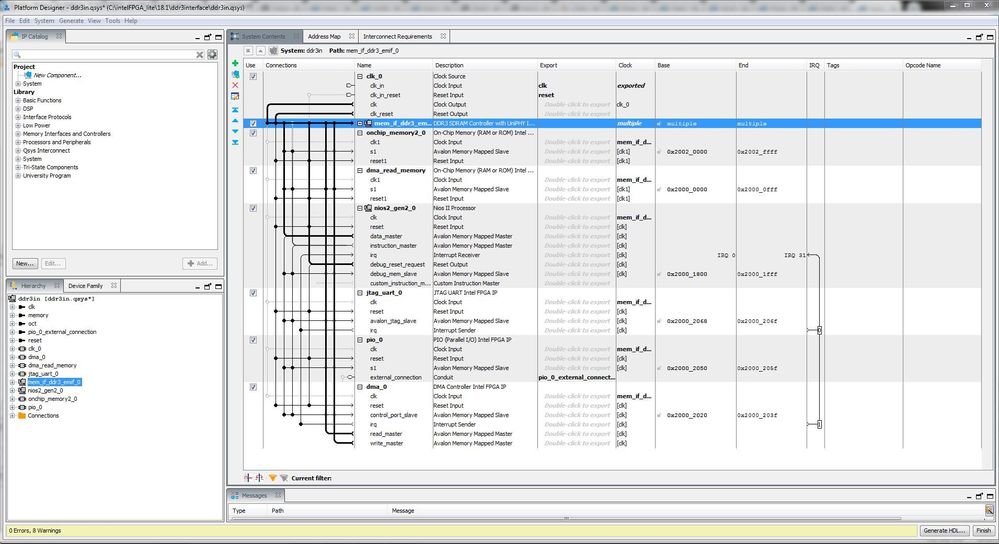

Below is Qsys system I have created(and same has been attached):

The error messages are not informational. Can you browse and see if there is other indications on what went wrong? Look at the 'Flow Messages'
- sstrell
What do the errors say?
So you're saying from this download (http://fpgadownload.intel.com/outgoing/devkit/13.0/cycloneVGT_5cgtfd9ef35_fpga_v13.0.0.1.zip) you opened the "golden top" project, compiled it, and got synthesis errors? Since the download is for an older version of Quartus, you would probably need to update the IP, but that project should be the starting point.

Yes I used that download but not compiled "golden top" . Instead I opened "q_sys_hmc.qsys" from "board_test_system" (examples\board_test_system\qts_ddr3\c5gt_ddr3\ ). From there opened ddr3 uniphy IP and made a preset with exactly same parameters and settings.
And further added that preset to my project and compiled it and got synthesis errors. You said that:
"Since the download is for an older version of Quartus, you would probably need to update the IP, but that project should be the starting point."
when I opened the example project I updated the IP, but what you mean by "that project should be the starting point"??
- sstrell
I mean you should take the example project, make sure it works, then customize it for your own use. Use the project itself as a base. Don't try to copy the settings you see in the example project into your own because you'll inevitably miss something.
#iwork4intel
- BoonT_Intel
Hi, one more thing is to compare your design QSF vs example design QSF. Spot out any setting that potentially cause the timing violation. the slack value is huge, there should be something obvious that cause the violation.
