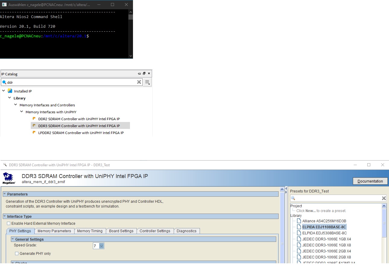

    • Elegan's avatar
      Elegan
      Hello Adzim,
      just gave it another try.
      1. Restarted Computer
      2. To see if everything is correct launched Nios2 Command shell (see attached screenshot)
      3. Picked DDR3 SDRAM Controller with UniPHY Intel FPGA IP from the IP Catalog
      4. To keep it simple: Selected Elpida EDJ1108BASE-8C from the Presets tab.
      5. Finish and generated it without Example Design
      It resulted in exactly the same Error log.
      Christian
