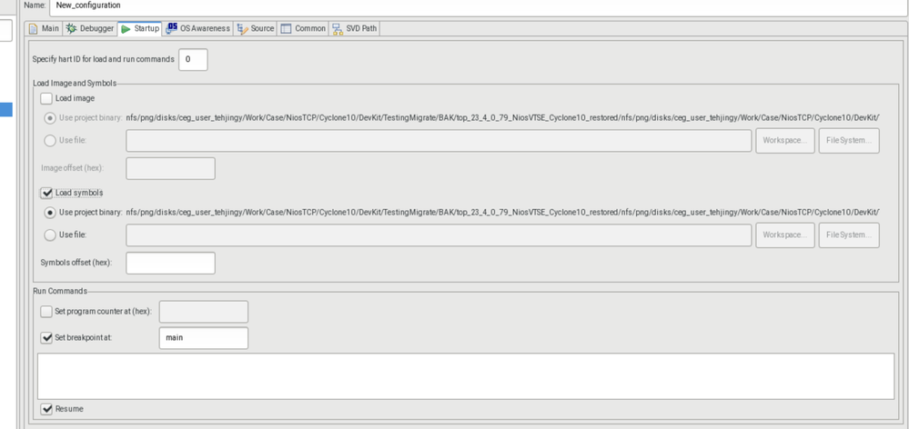

After you boot from the EP10CE25 flash, try attaching the debugger only without flashing the image.
Unselecting the load image option in the screenshot below:

I just notice that I did not attached the screenshot for the tab to just attached the debugger.
Please try taking a look at the previous comment on how to just attached the debugger.

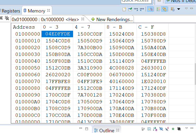

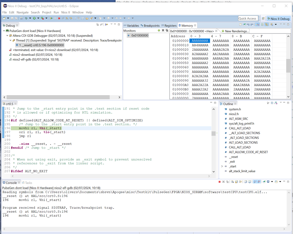

I couldn't find a screen that looked like your screenshot but I found a way to 'connect only'. The external memory doesn't look the same as when I download from the debugger (also attached) so I think that is evidence that the code isn't being copied.

It seems like the bootloader is not copying the code over to the load address.
