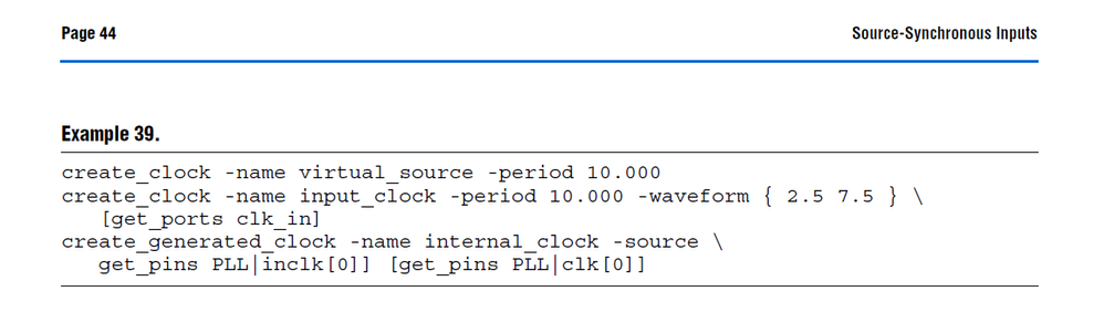

how to set timing constraints for source synchronous inputs
based on AN433 page 43~44.
Question 1:
We define both virtual clock and input clock here.
I think input clock is enough for timing constraint.
Why need both?
Question 2:
We define both input clock and generated clock after pll.
Then we which one should be used for define set_input_delay for data_in?
14 Replies

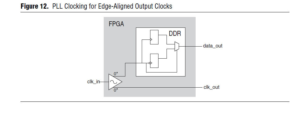

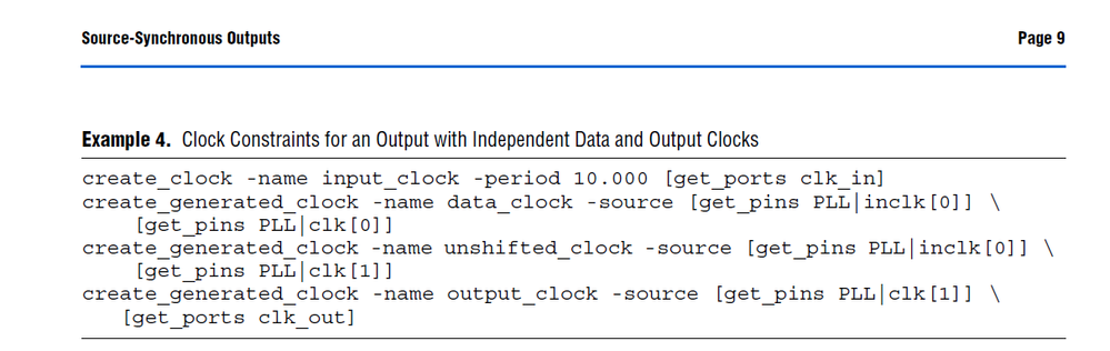

- XQSHEN
based on AN433 page 8~9.
Question 3:
why we need to create unshifted_clock and output_clock in 2 step?
I am not sure what's the purpose of unshifted_clock definition here.
Can we do it as below in 1 step?
create_generated_clock -name out_clock -source [get_pins PLL|inclk[0]] [get_ports clk_out]

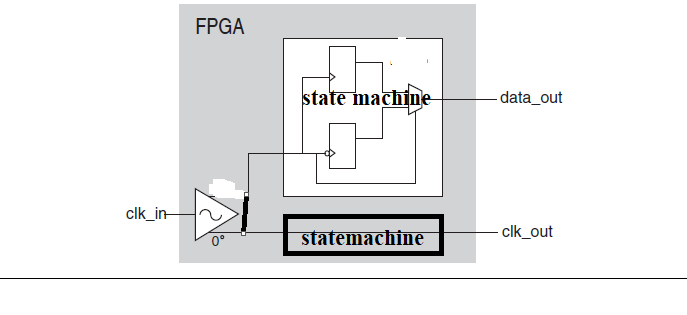

Question 4:
I used state machine get output data like below to external spi device.
clk_in = 25MHz -> pll_out = 50MHz -> clk_out = 6.25MHz.
actually, I used counter to get frequency down to 6.25MHz, and output to external device as spi clock.
How can define such kind sdc?

(1) Virtual and input clock constraints needed to define launch and latch edges for the analysis.
(2) set_input_delay always references the virtual clock, not any of the input or internal clocks.
(3) Just use derive_pll_clocks. The example is just showing that the output clock constraint needs to source the correct PLL output clock pin.
(4) So you're using the 50 MHz clock from the PLL as the source for the 6.25 MHz output clock? Just use the last constraint you referenced in (3) but include a frequency relationship (-divide_by 8).

Question 1) ~2):
Please refer to AN 433: Constraining and Analyzing Source-Synchronous Interfaces (intel.cn)
Page 41: It is not necessary to use a virtual clock to constrain the input delays. You can create
input delay constraints relative to the input clock instead of the virtual clock, but
using a virtual clock makes the constraining of the interface easier and more accurate.So, the documents say it's not a must to use virtual clock. But you told set_input_delay must use virtual clock.
I am not sure when I need to use virtual clock, and when I don't need to create virtual clock.
what's the relationship between virtual clock and data input clock?
I also don't see virtual clock used for any set_output_delay.

Yes, derive_pll_clocks is another method should work.
But my question is if I use the method of the example, is create unshifted_clock a must? I don't see it use anywhere later.
Can I remove the create_generated_clock of unshifted_clock? Because we only care about the clk_out for set_output_delay.

Question 4):
You mean like this:
create_generated_clock -name out_clock -source [get_pins PLL|inclk[1]] -divide_by 8 [get_ports clk_out]
set_output_delay -add_delay -clock [get_clocks {clk_out}] -max 10.000 [get_ports {data_out}]
But such sdc will report error.
Node: nios:nios_0|mcu_uadc:mcu_uadc_0|read_cnt[2] was determined to be a clock but was found without an associated clock assignment.
No paths exist between clock target "uadc_sclk" of clock "uadc_sclk" and its clock source. Assuming zero source clock latency.Here is the exact code in my project. uadc_sclk is the clk_out.

(1) For synchronous I/O, there's always a virtual clock and it should always be referenced for set_input_delay and set_output_delay. For source synchronous I/O, there's only a virtual clock for inputs since the FPGA generates the output clock that will latch the data. So set_input_delay references the virtual clock that drives the "upstream" device driving into the FPGA while set_output_delay for source synch always references the output generated clock coming from the FPGA itself.
(3) Again, it's just an example. You use the clocks you need. The easiest thing to do is what I said: use derive_pll_clocks and then create_generated_clock sourced from the appropriate output pin of the PLL.
(4) No. The -source for create_generated_clock should be the output pin of the PLL, not the input pin. And your set_output_delay is wrong because the -clock is referencing "clk_out" when you named the output clock "out_clock". So this should be:
create_generated_clock -name out_clock -source [get_pins PLL|clk[<output clock pin>]] -divide_by 8 [get_ports clk_out]
set_output_delay -add_delay -clock [get_clocks {out_clock}] -max 10.000 [get_ports {data_out}]
As for your error, I've never seen double "?" checks for a single assignment. I'm not sure what you're trying to do with this so it's not clear why read_cnt[2] is being seen as a clock. But that's not related to the constraints you've shown.

4) You can see above my verilog code for uadc_sclk. it's generated by counter of read_cn and write_cnt to make it frequency divided from pll clock 50MHz , down to 6.25MHz. But I don't know why timing analyzer report such error related to read_cnt.

I don't understand this question unless you separate into inputs and outputs. For source synchronous inputs, the virtual clock is the launch clock and the clock that drives the input registers (either direct clocking from upstream device or clock processed through a PLL) is the latch clock. You define this clock relative to the virtual clock (same edge or opposite edge requiring a phase shift). For source synchronous outputs, the launch clock is the clock that drives the output registers and the latch clock is the output generated clock.

I think you're also misunderstanding the meaning of a virtual clock. A virtual clock is still a real clock. It's just that it never actual enters the FPGA. Even though it never enters the FPGA, timing constraints (create_clock with no target specified) still need to describe its properties. Then, a create_clock command (with a target specified, usually the clock input port of the device) defines the relationship between the clock that actually enters the FPGA and the virtual clock. Having set_input_delay reference the virtual clock establishes the launch edge for an input analysis. The tool knows what clock domain drives the input latching registers of the FPGA so the latch edge is determined automatically simply by having set_input_delay target particular inputs.
