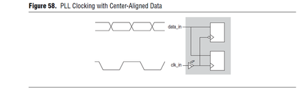

based on AN433 page 43~44.
Question 1:
We define both virtual clock and input clock here.
I think input clock is enough for timing constraint.
Why need both?
Question 2:
We define both ...
XQSHEN
4 years agobased on AN433 page 8~9.
Question 3:
why we need to create unshifted_clock and output_clock in 2 step?
I am not sure what's the purpose of unshifted_clock definition here.
Can we do it as below in 1 step?
create_generated_clock -name out_clock -source [get_pins PLL|inclk[0]] [get_ports clk_out]
